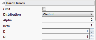

For each component in the diagram, you can either omit the component from calculations by checking the box next to Omit or:
• From the Distribution list, select the appropriate distribution. For all selections other than Nonparametric, enter parameter values for the distribution. For Nonparametric, see Specify a Nonparametric Distribution.
• For Series and Parallel components, you must also enter a value for N, the total number of components contained in the series or parallel shape.
• For K out of N components, you must also enter K, the minimum number of components that must function for the system to function, and N, the total number of components in the shape.
• For Knot components, enter the Minimum Available Dependences. The Knot shape enables you to configure a k-out-of-n shape where the shapes that are joined have different distributions. The Minimum Number of Dependencies is k, the minimum number of paths leading to the Knot that need to function in order for the system to function.
Figure 11.16 Example of a Weibull Configuration for a K out of N Shape
