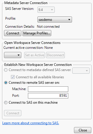

To begin, select File > SAS > Server Connections. The SAS Server Connections window shown in Figure 3.50 appears. All connections are made in this window.
Figure 3.50 SAS Server Connections

To connect to a Metadata Server
1. Select File > SAS > Server Connections. The SAS Server Connections window shown in Figure 3.50 appears.
2. Select the version for the SAS Server. Your SAS Metadata Server administrator should have this information.
SAS Server version 9.4 is selected by default based on the JMP SAS Integration preferences.
3. Select the profile that you want to use.
If you do not have a profile set up, see To create or modify a SAS Metadata Server profile.
4. Click Connect.
If JMP is unable to establish a connection, an error message appears. Common reasons are invalid user names or passwords. If you need to update the information for the profile, see To create or modify a SAS Metadata Server profile.
5. Click Close.

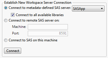

Once you are connected to a SAS Metadata Server, you can connect to any SAS Workspace Servers that the Metadata Server offers.
To connect to a SAS Workspace Server (Windows only)
2. Select the Workspace Server to connect to.
Figure 3.51 Open a Connection to a Workspace Server
3. Click Connect.
Under Open Workspace Server Connections, the Workspace Server is shown as the current active connection.
Figure 3.52 Current Active Connection
4. Click Close.

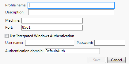

1. In the SAS Server Connections window, select the SAS Server Version.
2. Click Manage Profiles.
3. Click Add to add a new profile, or click Modify to change a profile’s settings.
The Create Profile or Modify Profile window appears. If you are adding a new profile, all fields are empty except the Authentication domain field, which contains DefaultAuth, and the Port field. If you are modifying a profile, the fields contain the current information.
Figure 3.53 Create or Modify a Metadata Server Profile
4. Fill in the information needed to connect to a SAS Metadata Server. Your SAS Metadata Server administrator should have this information.
Profile name
Select a name for this profile. This name is shown in the list of profiles.
Description
(Optional) You can enter a short description of this profile.
Machine
The name of the machine that hosts the Metadata Server. (Example: myserver.mycompany.com)
Port
The port through which you should connect to the machine. (Example: 8561)
Use Integrated Windows Authentication
Select this option to use your Windows log in ID and password to access the server. When enabled, the User name and password fields are disabled. This option is disabled by default.
User name
Your user name for the Metadata Server.
Password
Your password. This is always displayed as asterisks.
The domain you, as a user, belong to.
5. Click Save.

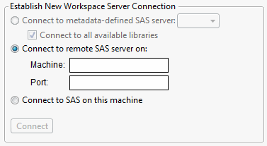

Connect to a Remote SAS Workspace Server
You can also connect directly to a SAS Workspace Server, instead of going through a Metadata Server.
To connect to a Remote SAS Workspace Server
2. Under Establish New Workspace Server Connection, select Connect to remote SAS server on.
Figure 3.54 Open a Connection to a Remote SAS Server
3. Enter the machine name and the port number. Your SAS server administrator has this information.
4. Click Connect.
5. Enter your user name and password in the window that appears.
6. Click OK.
7. Click Close in the SAS Server Connections window.
