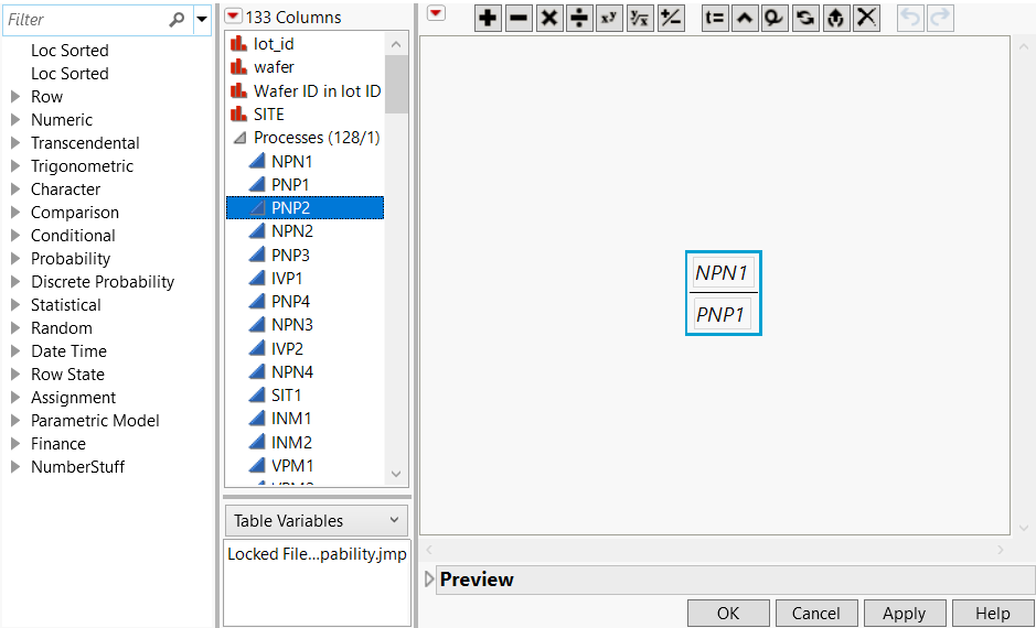

4. Select the first new column, select Cols, and then select Formula.
5. Create the formula NPN1/PNP1 and click OK.
Figure 7.11 Create the Formula NPN1/PNP1

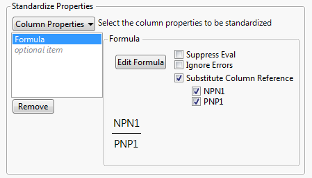

6. Select the three new columns and then select Cols > Standardize Attributes.
7. In the Standardize Properties section, select Formula from the list.
8. Select Substitute Column Reference and leave NPN1 and PNP1 selected.
Figure 7.12 Standardize Properties Options
Note: In this example, we want to change both NPN1 and PNP1. You can deselect the column that you do not want to change in the subsequent formulas.
9. Click OK.
A formula that is relative to the formula in the first new column is copied to the second and third selected columns.
The formulas in the second and third selected columns increment by one column.
