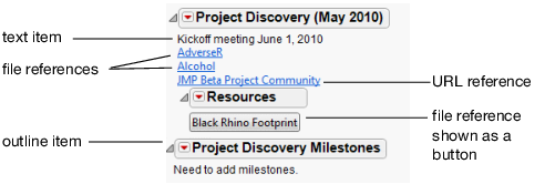

Figure 10.9 shows some of the items that you can add to a journal.
Figure 10.9 Example of a Journal
Note: Links to directories of files, windows, and all open files look like other links, so they are not included in the preceding figure.
