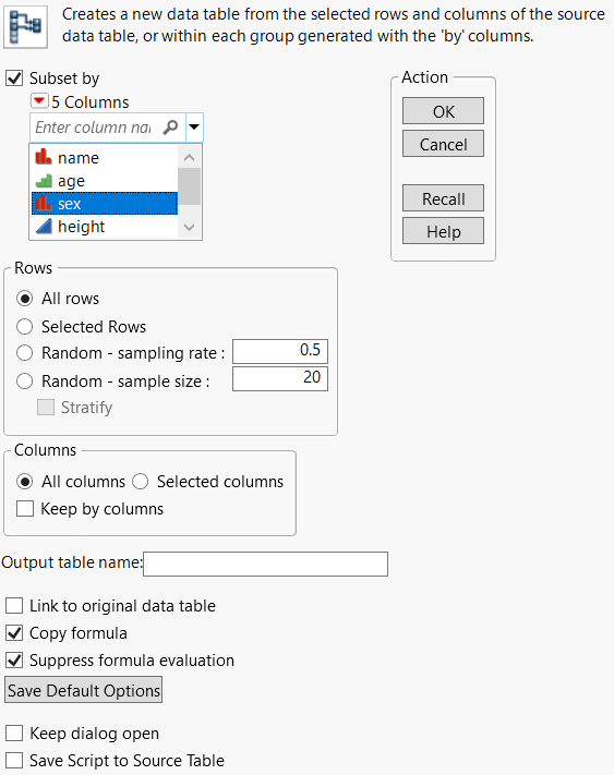

Figure 6.2 The Subset Window
2. Specify the content that you want to subset. Select any combination of the following:
– Subset by (the levels within selected columns)
– Rows (all, selected, or random)
– Columns (all or selected)
In Figure 6.2, the sex column will be subset.
3. Customize your subset table further using the additional options.
4. Click OK to create the subset table.

Subset by
Subsets by the levels of a column. Select Subset by and then select the columns that you want to categorize for the subset.
Consider the fact that many new data tables might be created. A new data table appears for each level of the column that you specified in the Subset window.
