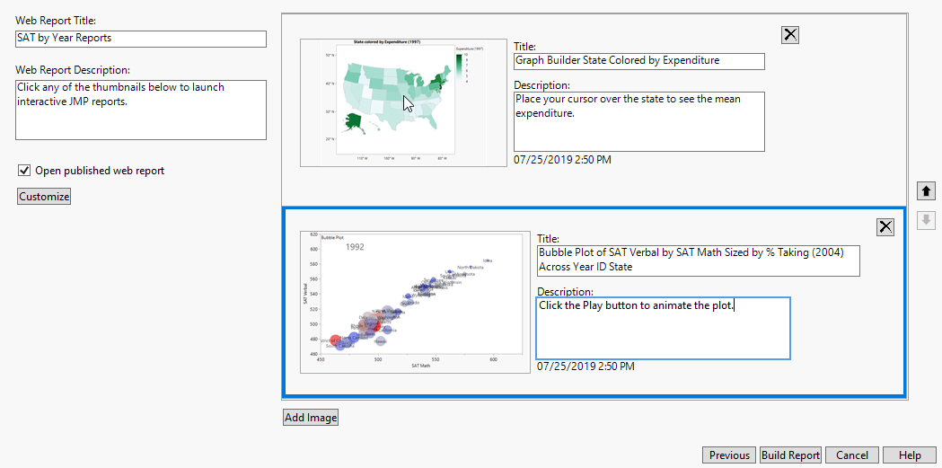

7. Enter SAT By Year Reports in the Web Report Title box.
8. Enter the descriptions and titles as shown in Figure 10.4.

Figure 10.4 Customizing the Web Report
Notes:
– The reports are in the order you created them. In this example, the Graph Builder Map script was run first, so the map is the first report. Use the arrows next to the reports to rearrange them. Also, after you remove a report, a Restore Reports button appears in case you want to add the report again.
– Click Add Image to append an image to the bottom of the report.
– Click Customize to find options for changing the font, logo, and more. See Web Report Options.

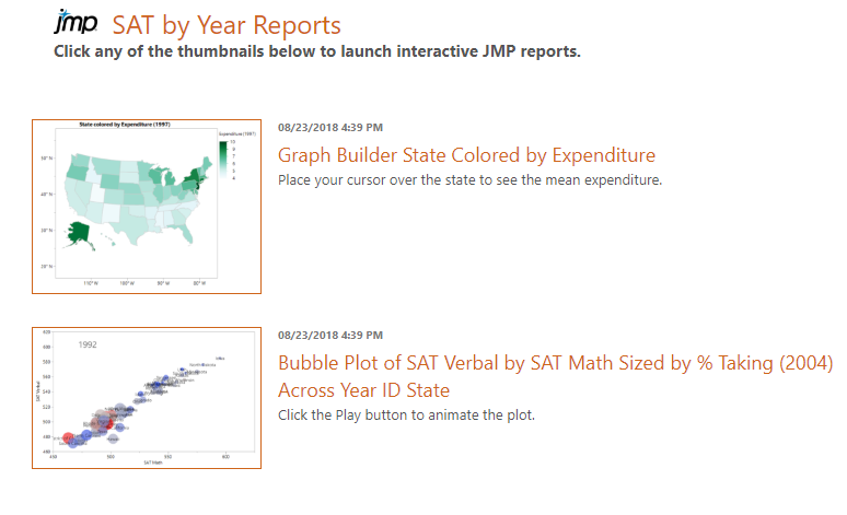

Figure 10.5 Web Report
10. Click one of the thumbnails to open the report in an interactive web page.

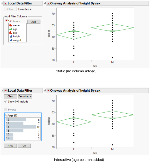

2. (Skip if your report does not contain a Local Data Filter.) If your report contains a Local Data Filter, add columns before you publish. This means you must select a column or columns in the Local Data Filter and click Add.
You will not be able to add filter columns after you publish the report. It will simply be static instead of interactive. See Figure 10.6.
Figure 10.6 Static and Interactive Local Data Filters

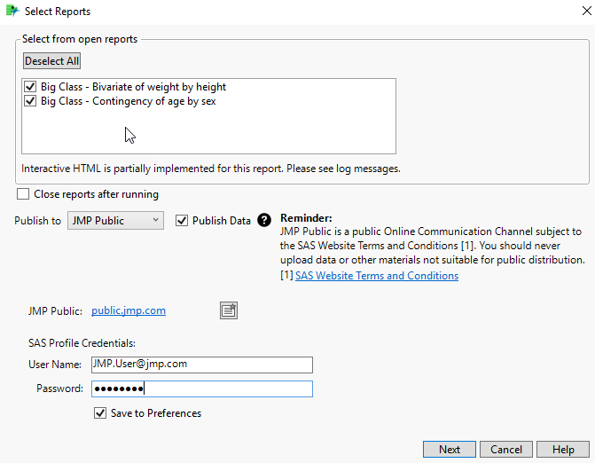

3. From a report window, select File > Publish.
4. Check the box next to the reports that you want to share, or click Select All.
5. Next to Publish to, select a JMP Live or JMP Public server.
Note the following:
– For JMP Live, you can enter a URL. If a URL appears, it is set under File > Preferences > Reports > JMP Live URL.
– If you do not see a JMP Public server, JMP Public might not be enabled for your organization.
Figure 10.7 Select Reports Window
6. Click Sign in. Enter your user name and password, and then click Sign in.
7. (Optional) To save (bookmark) the URL, or change the server name. Click Edit bookmark
a. To change the server name, click in the active URL box and enter a new name.
b. To save the server name as an option under Publish to, create a bookmark. Click Create bookmark and enter a bookmark name. Click OK.
c. To edit an existing bookmark, click Edit bookmark and change the name or URL.
8. (Optional) To publish the data tables associated with the reports and make the reports interactive, Publish Data should be selected. If you deselect this, data are not embedded and the graphs are static.
9. Click Next.

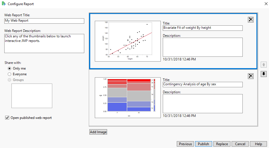

10. (Multiple reports only) At left, enter a title and an optional description for your overall post. You can also:
– Change the order of the individual reports by clicking the arrows on the right.
– Delete a report by clicking .
11. On the right, enter a title and an optional description for each report.
12. (Optional) To open the post after creating it, check Open published web report.
13. Choose who to share with: Only Me, Everyone, or Groups:
– Only Me means that your report is visible to you only. An orange lock icon appears on the report in JMP Public or JMP Live to indicate that it is private.
– To share your report with everyone on JMP Public or JMP Live, choose Everyone.
– To share your report with a group or groups, choose Groups and select the groups that you want to share the report with.
14. (Optional, multiple reports only) To add images, click Add Image. You can also enter a title and description.
15. Click Publish. Or, if you are updating an existing post, click Replace. When replacing a post, make sure that the titles match.
