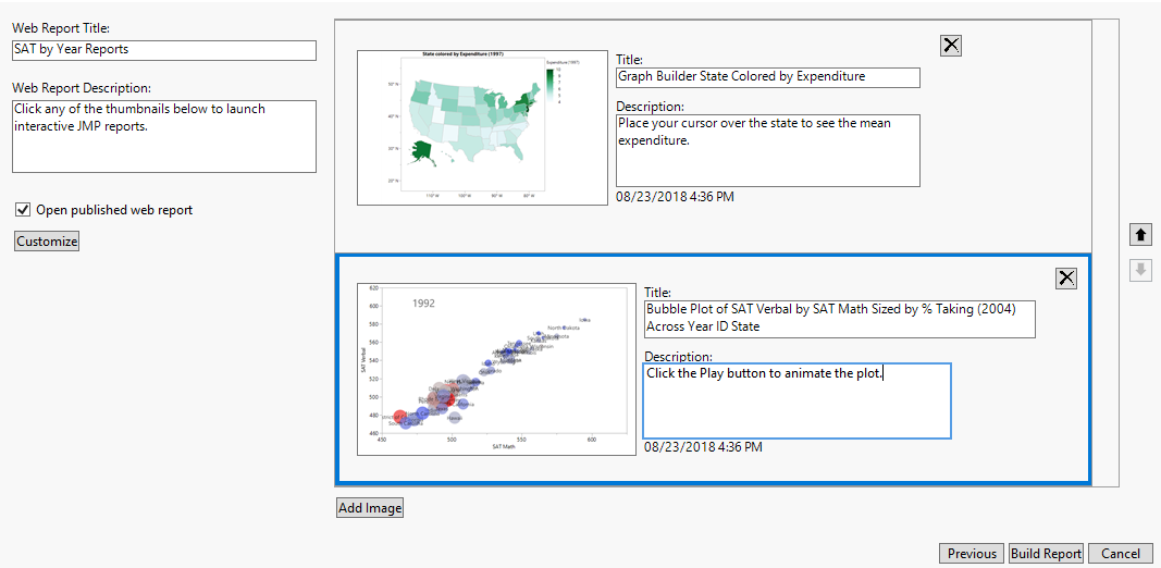

6. Enter the descriptions shown in Figure 7.17.

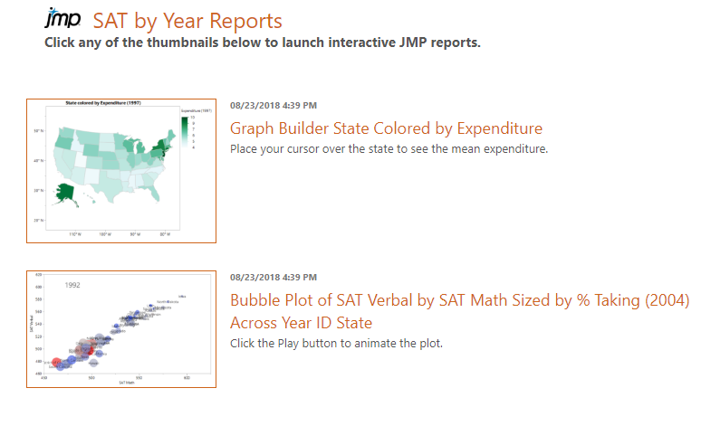

Note: If you selected one report, you have the option of generating an index page. The index page shows a thumbnail of the report. You click the thumbnail to view the report. Figure 7.18 shows an example.
Figure 7.17 Customizing the Web Report
Notes:
– The reports are in the order you created them. In this example, the Graph Builder Map script was run first, so the map is the first report. Use the arrows next to the reports to rearrange them. Also, after you remove a report, a Restore Reports button appears in case you want to add the report again.
– Click Add Image to append an image to the bottom of the report.

8. Click Build Report.
The web page opens in your default browser.
Figure 7.18 Web Report
