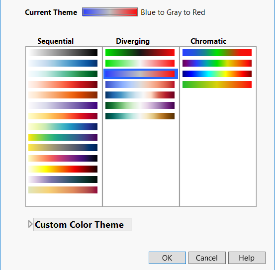

2. To either create a new Continuous Color Theme or Categorical Color Theme, click the appropriate color theme.
If you are creating a new continuous color theme, the Continuous Color Themes window appears.
Figure 4.29 Continuous Color Themes Window
The sequential color “Cividis” is a form of Viridis that is designed for viewing with color limitations.

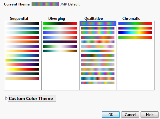

If you selected to create a new categorical color theme, the Categorical Color Themes window appears.
Figure 4.30 Categorical Color Themes Window

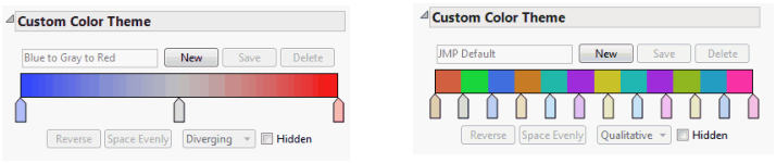

4. Click the Custom Color Theme disclosure icon to show the Custom Color Theme panel.
Figure 4.31 shows the color theme panels for both continuous and categorical themes (respectively).
Figure 4.31 Custom Color Theme Panel
5. Click New to create a new theme.
A new color theme is created based on the selected color theme. A temporary name is assigned to the theme.
6. Type a new name in place of the temporary label. On Windows, do not press Enter. The window closes if you do so.
7. To modify the color theme, do any of the following:
– To modify the gradient of continuous color, move the sliders left or right.
– To add more colors to the gradient, click the color bar to choose a color. A new slider is displayed under the color bar.
– To change the color of a slider, click the slider to display the Color window and choose another color.
– To reverse the order of the colors on the gradient, click Reverse.
– To distribute the colors evenly on the gradient, click Space Evenly.
– To list the custom theme in the Sequential pane, select Sequential from the list.
– To list the custom theme in the Diverging pane, select Diverging from the list.
– To list the custom theme in the Chromatic pane, select Chromatic from the list.
– To prevent a theme from appearing in lists of color themes, select Hidden.
– To remove a color from the color theme, click the color’s slider and drag the slider above or below the color bar.
– To discard your changes, click Cancel.
8. Click Save to save the custom color theme.
The new custom color theme is appended to the contents of the selected pane.
9. Click OK to close the color theme window.

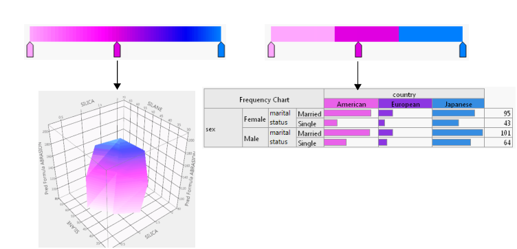

Continuous and Categorical Color Themes
The following figure shows examples of the two types of color themes in JMP, continuous and categorical. When a color theme is selected for continuous data, the colors are graduated (as shown on the left). When the same color theme is selected for categorical data, the color consists of distinct blocks of color. (as shown on the right).
Figure 4.32 Examples of Continuous and Categorical Color Themes
