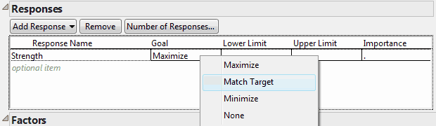

2. Double-click Y under Response Name and type Strength.
Note that the default Goal is Maximize. Your goal is to find factor settings that enable you to brew coffee with a target strength of 1.3, within limits of 1.2 and 1.4.
3. Click the default Goal of Maximize and change it to Match Target.
Figure 3.4 Selection of Match Target as the Goal
4. Click under Lower Limit and type 1.2.
5. Click under Upper Limit and type 1.4.
6. Leave the area under Importance blank.
Because there is only one response, that response is given Importance 1 by default.
The completed Responses outline appears in Figure 3.5.

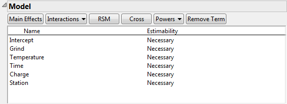

Model Outline
Figure 3.7 shows the Model outline. The Model outline is where you specify your assumed model, which contains the effects that you want to estimate. See Specify. The list that appears by default shows all main effects as Necessary, indicating that the design is capable of estimating all main effects. Because your main interest at this point is in the main effects of the factors, you do not add any effects to the Model outline.
Figure 3.6 Model Outline with Main Effects Only

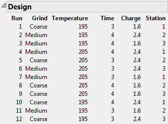

The Design and Design Evaluation outlines are added to the Custom Design window. The Output Options panel also appears.
The Design outline shows the design (Figure 3.8). If you did not follow the steps in Steps to Duplicate Results (Optional), your design might be different from the one in Figure 3.8. This is because the algorithm begins with a random starting design.
Figure 3.8 Design for Coffee Experiment

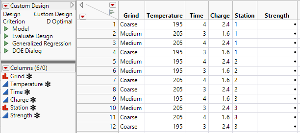

1. Click Make Table.
The data table shown in Figure 3.10 opens. Keep in mind that, if you did not follow the steps in Steps to Duplicate Results (Optional), your design table might be different. Your design table represents another optimal design.
Figure 3.10 Custom Design Table
Note the asterisks in the Columns panel to the right of the factors and response. These indicate column properties that have been saved to the columns in the data table. These column properties are used in the analysis of the data. See Factors and Factor Column Properties.
