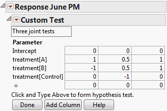

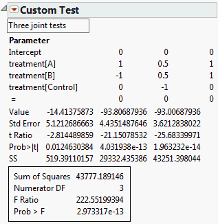

Figure 3.26 shows an example of the specification window with three contrasts, using the Cholesterol.jmp sample data table. Note that the constant is set to zero for all three tests. The report for these tests is shown in Figure 3.27.

Suppose that you want to test three contrasts. You want to compare the mean responses for the following:
• treatment A to treatment B
• treatments A and B to the control group
• treatments A and B to the control and placebo groups
To test these contrasts using Custom Test:
1. Select Help > Sample Data Library and open Cholesterol.jmp.
3. Select June PM and click Y.
4. Select treatment and click Add.
5. Click Run.
6. Click the red triangle next to Response June PM and select Estimates > Custom Test.
7. In the Custom Test specification window, click Add Column twice to create three columns.
8. Fill in the editable area with a test name and enter values in the three columns as shown in Figure 3.26.
To see how to obtain these values, particularly those in the third column, see Interpretation of Parameters in the Statistical Details section.
Figure 3.26 Custom Test Specification Window for Three Contrasts
9. Click Done.
The results shown in Figure 3.27 indicate that all three hypotheses are individually, as well as jointly, significant.
Figure 3.27 Custom Test Report Showing Tests for Three Contrasts
