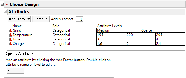

You can enter factors either manually or automatically using a preexisting table that contains the factors and settings. In this example, for convenience, you use a preexisting table. But, if you are designing a new experiment, you must first enter the factors manually. For more information about entering factors manually, see Attributes.
1. Select DOE > Consumer Studies > Choice Design.
2. Select Help > Sample Data Library and open Design Experiment/Coffee Choice Factors.jmp.
3. Click the Choice Design red triangle and select Load Factors.
Figure 18.2 Choice Design Window with Attributes Defined
4. Click Continue.

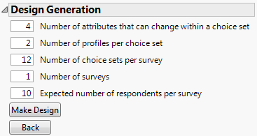

6. In the Design Generation panel:
– Keep the Number of attributes that can change within a choice set at 4.
– Keep the Number of profiles per choice set at 2.
– Type 12 for the Number of choice sets per survey.
In this example, the respondents evaluate 12 choice sets.
– Keep the Number of surveys at 1.
– Type 10 for the Expected number of respondents per survey.
In this example, there are ten respondents.
Figure 18.3 Completed Design Generation Panel
