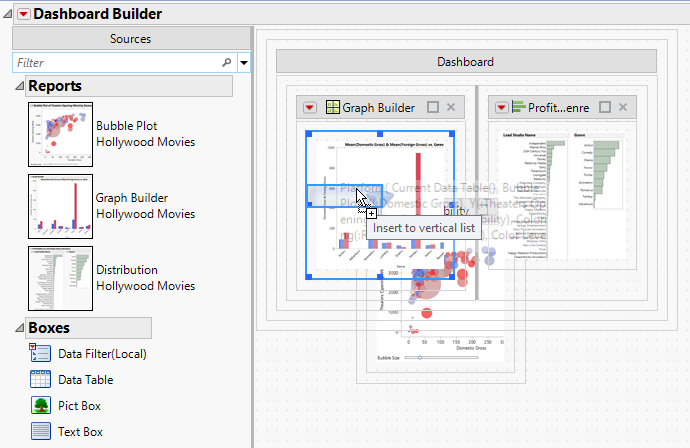

Add and Use Selection Filters
1. Right-click the center of the left report (Graph Builder) and select Use As Selection Filter.
2. To add another report as a second selection filter, click the Bubble Plot thumbnail and drag it into the blue line around the Graph Builder graph.
Figure 11.13 Dragging the Bubble Plot into the Graph Builder Graph
A filter icon appears on both thumbnails.

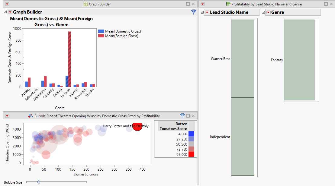

3. Click the Dashboard Builder red triangle and select Preview Mode.
4. Select one of the bars for the Fantasy genre in the left report.
Figure 11.14 Filtering Data
In the right report, you can see that Warner Bros and Independent studios produced the most fantasy movies. In the bottom report, you can see that Harry Potter was the most profitable fantasy movie.
