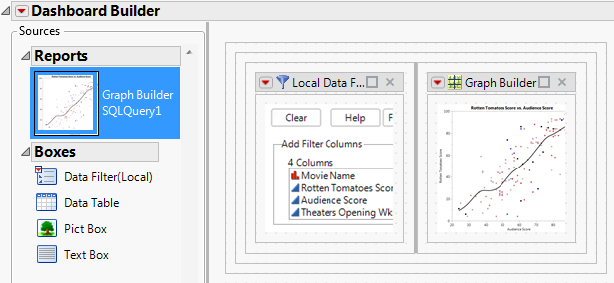

Create the Dashboard
1. From the report window, select File > New > Dashboard.
2. Select the Blank Dashboard template.
3. Double-click the Data Filter(Local) box in the left pane to add it to the dashboard.
4. Double-click the Graph Builder report in the left pane to place it next to the local data filter.
Figure 11.15 Dashboard for Hollywood MoviesĀ

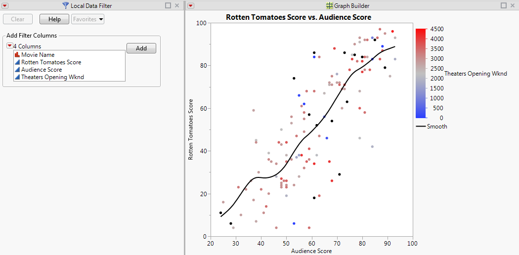

6. From the JMP main menu, select Add-Ins and select Hollywood Movies Dashboard.
The Hollywood Movies.jmp data table is queried, and the dashboard opens to show the local data filter and updated report.
Figure 11.16 Hollywood Movies Add-InĀ
