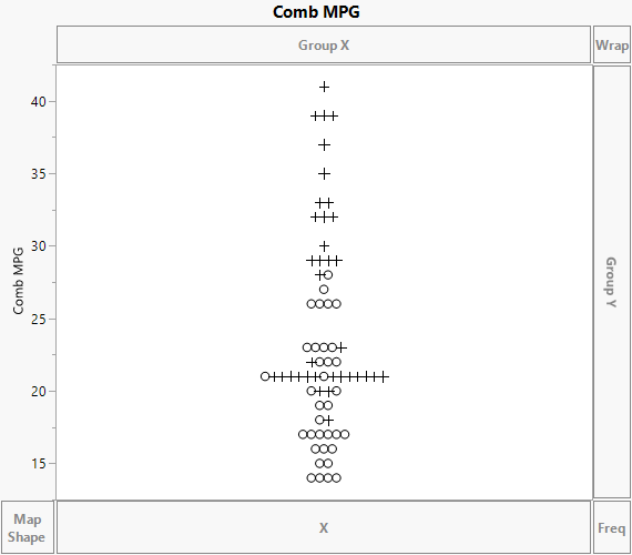

3. Select Comb MPG (combined miles per gallon) and drag it to the Y zone.
Figure 3.4 Initial Graph of Combined MPG
Because markers are assigned to rows in the data table, points are represented by those markers. The value of Comb MPG for each row is plotted at its value on the vertical axis. To avoid over-plotting points that correspond to observations with the same Comb MPG values, JMP automatically jitters the points.

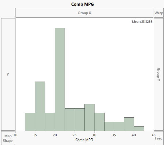

You can get a cleaner picture of the distribution by plotting a histogram.
4. Click the Histogram icon .
You want the histogram to be vertical, so you need to move Comb MPG to the X zone.
5. Place your cursor over Comb MPG in the Y axis. The cursor turns into a hand. Select and drag Comb MPG into the X zone.
6. Click the Caption Box icon to show the mean Comb MPG on the graph.
Figure 3.5 Histogram of Combined MPG
The histogram shows that Comb MPG can range widely, from about 10 to 45. However, a lot of vehicles get mileage between 15 and 30. The mean MPG is 23.3286.

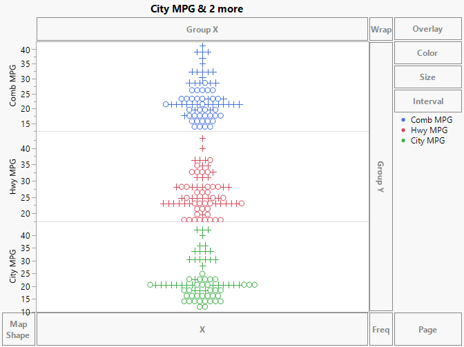

2. Select City MPG, Hwy MPG, and Comb MPG.
3. Place your cursor over the Y zone with your cursor, press Shift, and click in the Y zone.
This creates separate Y axes for City MPG, Hwy MPG, and Comb MPG.
Figure 3.6 MPG Variables with Separate Y Zone Axes
In the legend at right, markers are colored according to the driving type.
Tip: To change the color assigned to a driving type, right-click the marker in the legend.

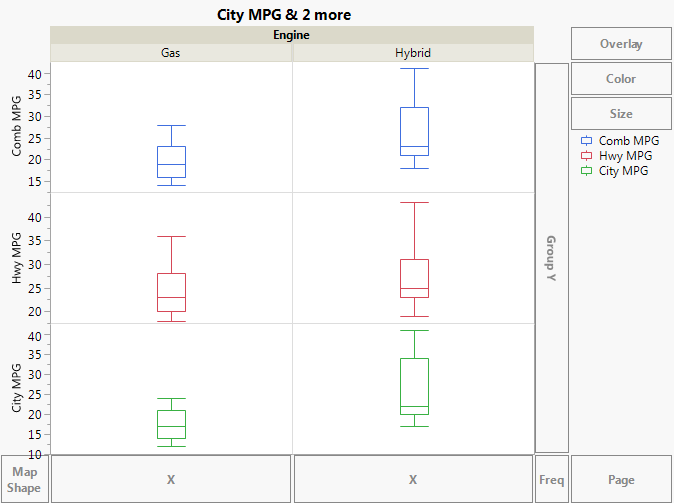

4. Drag Engine to the Group X zone.
5. Click the Box Plot icon .
Figure 3.7 Boxplots of MPG Variables by Engine Type

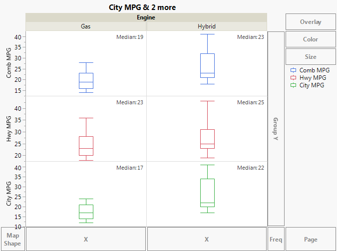

The boxplots show the distributions in a very compact form. You can see that all three types of MPG values are substantially lower for the gas vehicles than for the hybrids in the study. From the horizontal lines in the centers of the two City MPG boxplots, you can estimate that the median difference is about five miles per gallon. However, you can use the Caption element to be sure.
6. Click the Caption Box icon .
7. In the Caption Box options at the left of the plot, select Median from the Summary Statistic list for Comb MPG, Hwy MPG, and City MPG.
Figure 3.8 Boxplots of MPG Variables with Captions
The median city MPG for gas engines is 17 and for hybrid engines is 22.

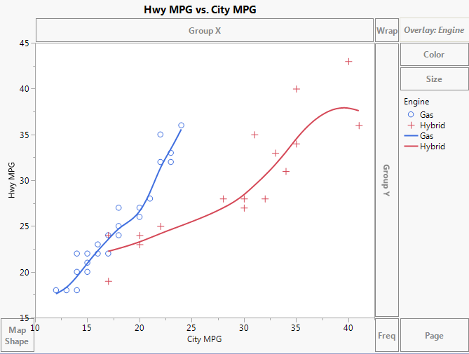

2. Select City MPG and drag it into the X zone.
3. Select Hwy MPG and drag it into the Y zone.
4. Select Engine and drag it into the Overlay zone.
Figure 3.9 Hwy and City MPG by Engine Type
A Smoother appears for each type of engine, Gas, and Hybrid.
Tip: To change the line properties (color, width, and so on), right-click a line in the legend.
5. Click the Line of Fit icon .
For each engine type, the smoother is removed and a least squares line, together with confidence bands for the predicted mean, is added.
Tip: To add the y = x line, right-click in the graph and select Customize > + > Templates > Y Function. Replace _function_of_x_ with y = x and click OK.

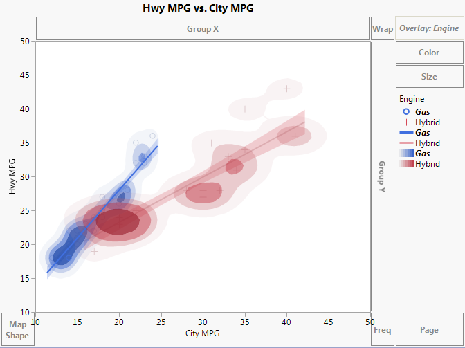

7. Drag the Contour icon into the graph.
Dragging the Contour icon into the graph retains the Line of Fit for each engine type.
Figure 3.10 Density Contour for Hwy and City MPG by Engine Type
The contours indicate that for both engine types, there are more vehicles in the study with lower MPG values than higher MPG values.
