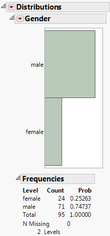

Figure 11.1 Distribution of Gender in Lipid Data.jmp
Figure 11.1 illustrates the distribution of Gender in the data set. Notice that there is not an equal proportion of males and females represented. Because there are fewer females within the data, you want to be sure to balance the genders across the validation and training sets.

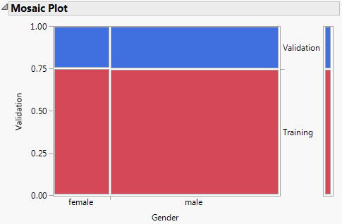

Figure 11.2 Distribution of Gender across Validation and Training Sets
Figure 11.2 illustrates the distribution of Gender across each of the validation and training sets. Note that about 75% of both females and males are in the training set and about 25% of both females and males are in the validation set.
