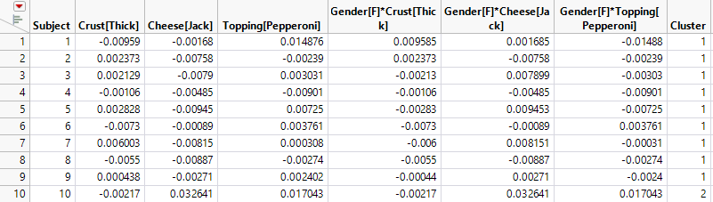

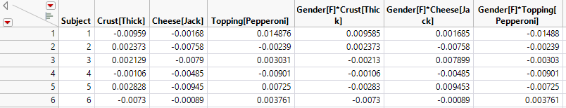

3. Click the Choice Model: Choice red triangle and select Save Gradients by Subject.
A data table appears with gradient forces saved for each main effect and subject interaction.
Figure 4.33 Gradients by Subject for Pizza Data, Partial View

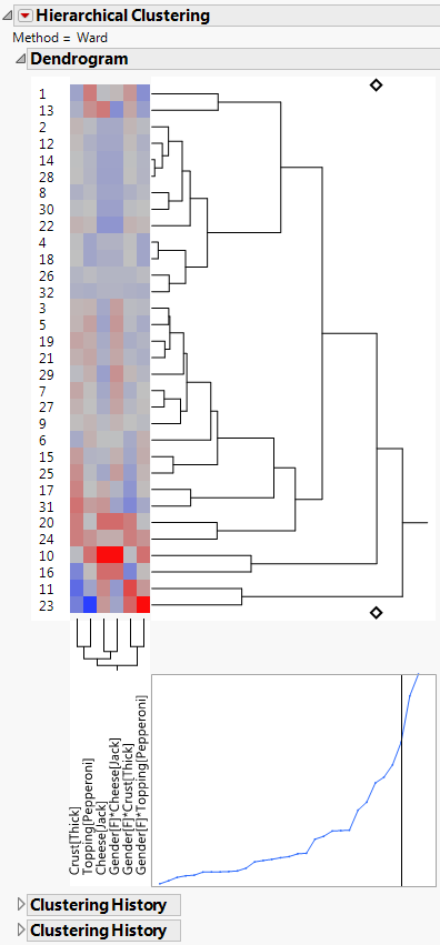

Figure 4.34 Dendrogram of Subject Clusters for Pizza Data
The script runs a hierarchical cluster analysis on all columns in the gradient table, except for Subject. Click either diamond to see that the rows have been placed into three clusters.

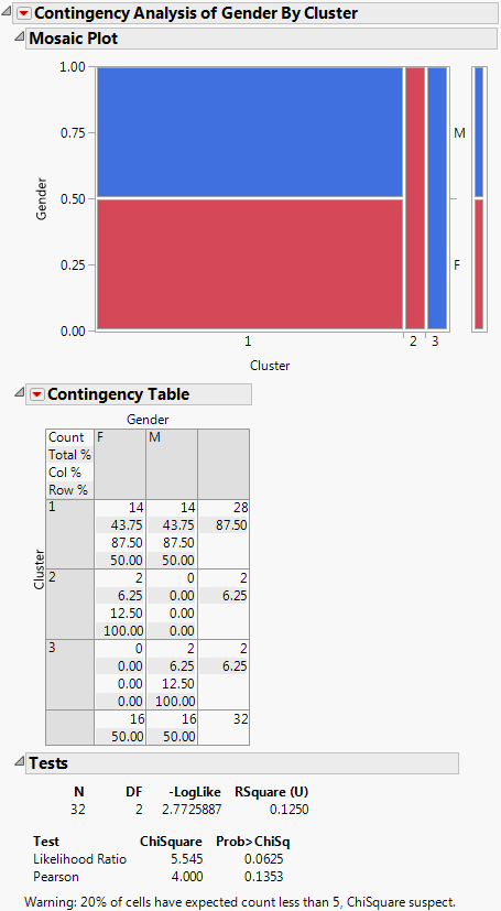

Figure 4.36 Contingency Analysis of Gender by Cluster
You see the following:
– Cluster 1 is evenly divided between males and females
– Cluster 2 consists of only females
– Cluster 3 consists of only males
