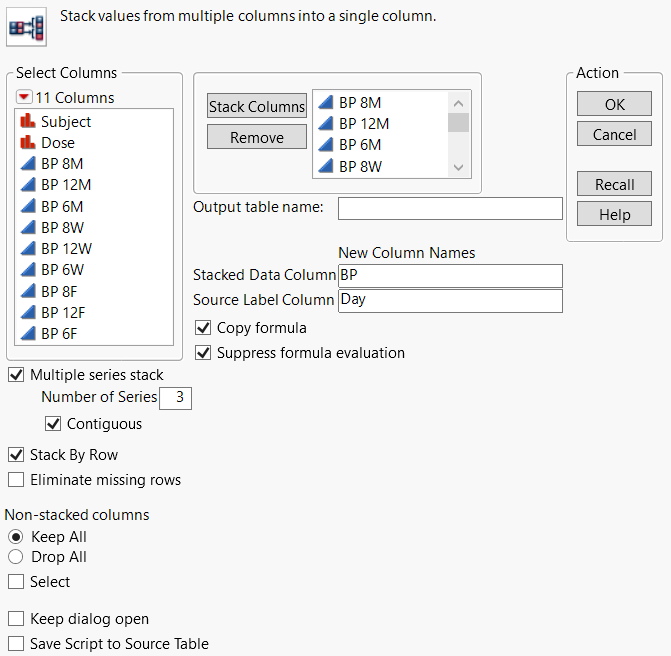

3. Select all of the BP readings and click Stack Columns.
The order of the columns reflects how the columns in the series should be grouped.
4. Select Multiple series stack.
5. Next to Number of Series, type 3.
6. Because you want to stack the columns vertically, select Contiguous.
7. Rename the Stacked Data Column from Data to BP (for blood pressure).
8. Rename the Source Label Column from Label to Day.
Figure 6.10 Completed Stack Window
9. Click OK.
