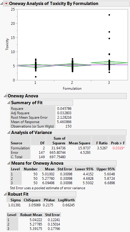

The data in the Drug Toxicity.jmp sample data table shows the toxicity levels for three different formulations of a drug.

6. Click the red triangle next to Oneway Analysis of Toxicity By Formulation and select Means/Anova.
7. Click the red triangle next to Oneway Analysis of Toxicity By Formulation and select Robust > Robust Fit.
Figure 6.31 Example of Robust FitĀ
If you look at the standard Analysis of Variance report, you might wrongly conclude that there is a difference between the three formulations, since the p-value is 0.0319. However, when you look at the Robust Fit report, you would not conclude that the three formulations are significantly different, because the p-value there is 0.21755. It appears that the toxicity for a few of the observations is unusually high, creating the undue influence on the data.
