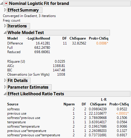

Figure 11.9 Nominal Logistic Fit for Three-Factor Factorial Model
The Whole Model Test report shows that the three-factor full factorial model as a whole is significant (Prob>ChiSq = 0.0006).
The Effect Likelihood Ratio Tests report shows that the effects that include softness do not contribute significantly to the model fit. This leads you to consider removing softness from the model. You can do this from the Effect Summary report.
7. In the Effect Summary report, select softness*previous use through softness under Source and click Remove.

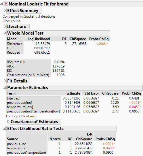

The report updates to show the two-factor factorial model (Figure 11.10). The Whole Model Test report shows that the two-factor model is also significant as a whole.
Figure 11.10 Nominal Logistic Fit for Two-Factor Factorial Model
You conclude that previous use of a detergent brand and water temperature have an effect on detergent preference. You also note that the interaction between temperature and previous use is not statistically significant, so there is no evidence that temperature depends on previous use.
