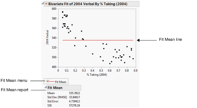

Each fitting option adds the following:
• a line, curve, or distribution to the scatterplot
• a red triangle menu to the report window
• a specific report to the report window
Figure 5.5 Example of the Fit Mean Option
The following fitting options are available:
Fit Mean
Adds a horizontal line to the scatterplot that represents the mean of the Y response variable. See Fit Mean.
