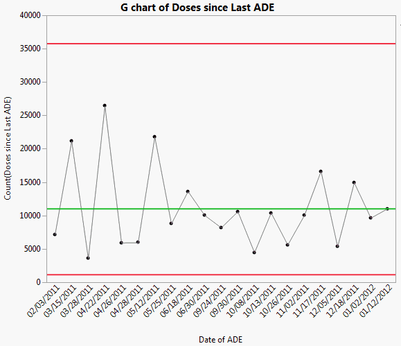

An Individual & Moving Range chart of Doses since Last ADE appears.
5. In the drop-down list, select Rare Event instead of Shewhart Variables.
A G chart of Doses since Last ADE appears showing the number of doses given since the last event.
Figure 3.23 G chart of Doses since Last ADE
