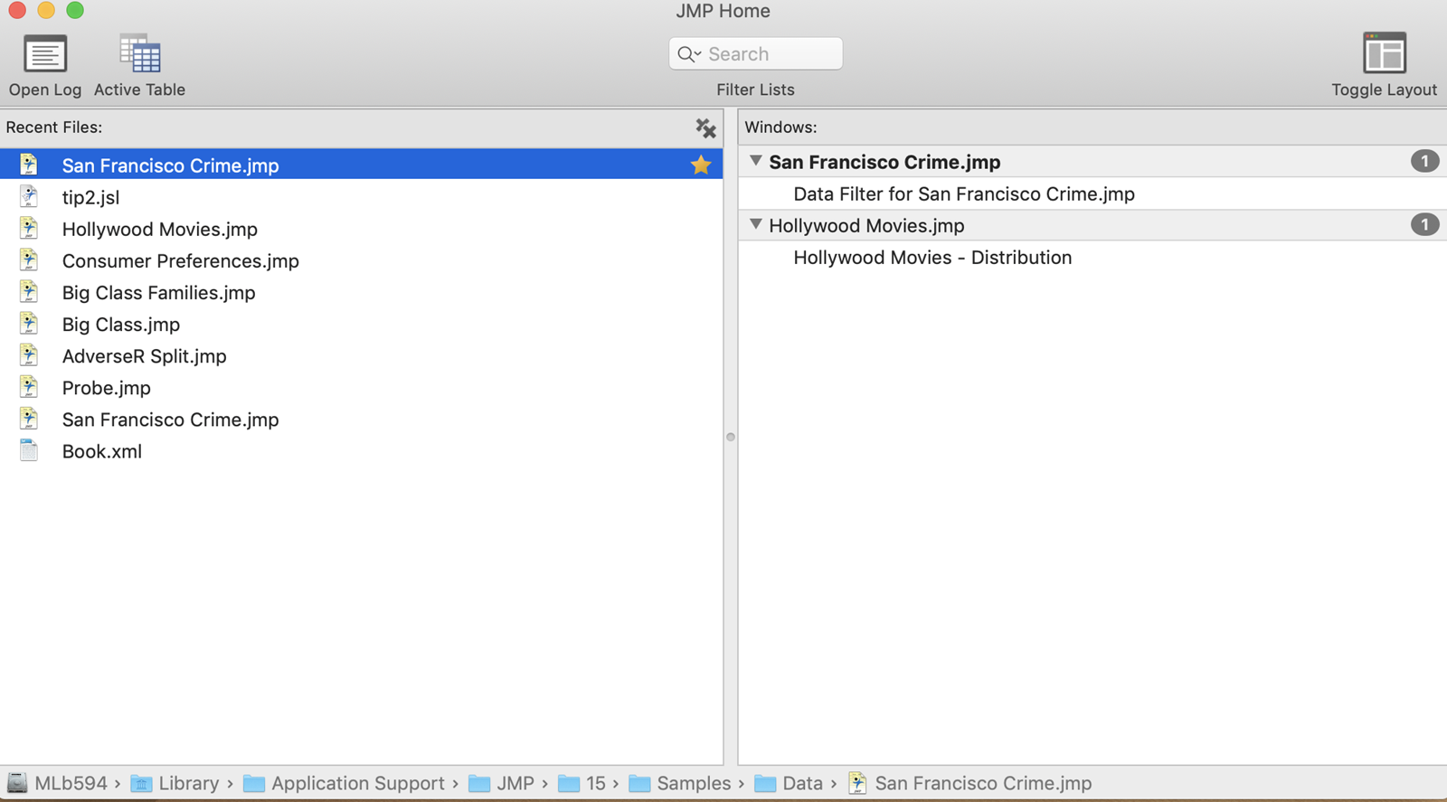

Open the JMP Home window on macOS by selecting Window > JMP Home (Figure 2.15). To view the window each time you open JMP, select JMP > Preferences > General > Home Window.
Figure 2.15 Example of the JMP Home Window (macOS)

• The Status bar area shows the path for the currently selected file. You can click a folder to open the folder to view its contents.
