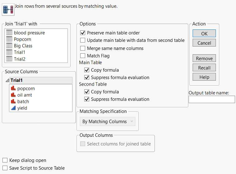

In the window that appears, the names of all open tables appear below Join...with.
Figure 6.22 The Join Window
3. In the Join...with box, select the table to join with the active table.
4. From the Matching Specification area, select the option that specifies how to join the tables.
5. Enter the name of the new table in the text box beside Output table name.
6. (Optional) Customize the join procedure further using the additional options.
7. Click OK to create the joined data table.
Join Options
Keep dialog open
Keeps the Join window open after you click OK.
Save Script to Source Table
Saves a script to the original data table that enables you to join the data again using the same settings.
Preserve main table order
Maintains the order of the original data table in the joined table, instead of sorting by the matching columns. Selected by default.
Update main table with data from second table
Data in the original table are updated with data in columns that have the same names. The results are displayed in a new data table. Data in the original table are updated with data in columns that have the same names.
Note the following:
– JMP does not replace data with missing values.
– The output table uses the same columns as the original table. Thus, when you use Update main table with data from second table, Select Columns for joined table is not applicable.
– The Update main table with data from second table option is available only when joining by row number or by matching columns.
Merge same name columns
Data from the second table replaces the data of the same name columns in the original table. Note that missing values in the first table are replaced by nonmissing values in the second.
If you are matching by column, Match Flag is selected when you select Merge same name columns. The new joined table contains a nominal column named Match Flag:
– If Main appears in this column, the data originated from the first (active) table.
– If With appears in this column, the data originated from the second table.
– If Both appears in this column, the data was found in both the first and second tables.
Match flag
Determines whether the Match Flag column is created when you are matching by column. Selected automatically when you select Merge same name columns.
Copy formula (Main Table and Second Table)
Includes formulas from the main table and/or the second table in the output columns. Selected by default.
Suppress formula evaluation (Main Table and Second Table)
Prevents JMP from evaluating columns’ formulas during the creation of the new table. Selected by default.
