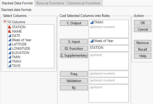

Launch the Functional Data Explorer platform by selecting Analyze > Specialized Modeling > Functional Data Explorer.
Figure 15.5 Functional Data Explorer Launch Window
The Launch Window includes tabs for three different types of data formats.
Stacked Data Format
In this data format, each row corresponds to a single observation. There are separate columns for the output, input, and ID variables.
Note: The Stacked Data Format is the only data format that enables you to specify multiple functional processes. If you assign more than one column to Y, Output in the Stacked Data Format tab, each Y variable is analyzed separately. A Fit Group report contains the individual reports for the Y variables.

Y, Output
Assigns the functional process, f(t). There must be at least two observed output values for each level of the ID variable.
X, Input
(Available for Stacked Data Format and Columns as Functions.) Assigns the input variable t. If no variable is specified for X, Input, the row number is used instead. Using the row number assumes that the observations are equally spaced in the input domain.
ID, Function
(Available for Stacked Data Format and Rows as Functions.) Assigns the ID variable to each function. If no ID variable is assigned in the Stacked Data Format tab, all observations are assumed to come from only one function.
