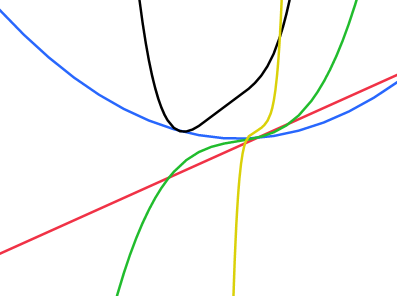

Polynomials
where k is the order of the polynomial. These models can also be fit using the Fit Model and Fit Y by X platforms.

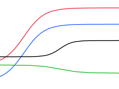

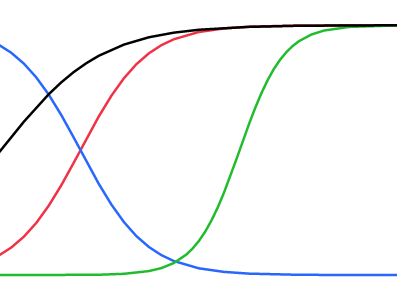

Logistic 2P
a = Growth Rate
b = Inflection Point
Available only when all response values are between zero and one.
Logistic 3P
a = Growth Rate
c = Asymptote

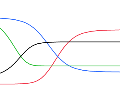

Logistic 4P
a = Growth Rate
c = Lower Asymptote
d = Upper Asymptote
Logistic 4P Rodbard
a = Growth Rate
c = Lower Asymptote
d = Upper Asymptote
Available only when the regressor values are positive.
Logistic 4P Hill
a = Growth Rate
c = Lower Asymptote
d = Upper Asymptote
Logistic 5P
a = Growth Rate
c = Asymptote 1
d = Asymptote 2
f = Power
Probit 2P
a = Growth Rate
Φ = Normal Distribution CDF
Probit 4P
a = Growth Rate
c = Asymptote 1
d = Asymptote 2

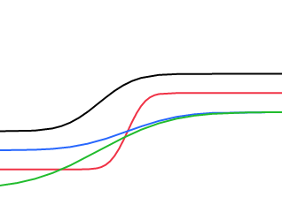

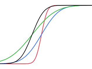

Gompertz 3P
a = Asymptote
b = Growth Rate
c = Inflection Point
Gompertz 4P
a = Lower Asymptote
b = Upper Asymptote
c = Growth Rate
d = Inflection Point
Weibull Growth
a = Upper Asymptote
b = Growth Rate
Available only when both the response values and regressor values are non-negative.

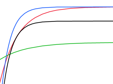

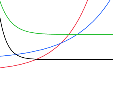

Exponential 2P
a = Scale
b = Growth Rate
Exponential 3P
a = Asymptote
b = Scale
c = Growth Rate

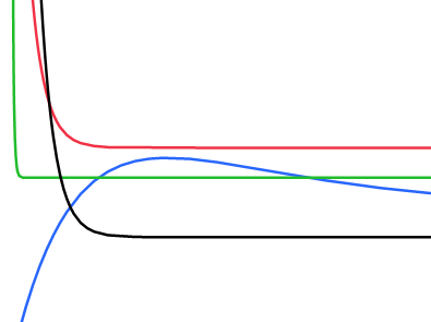

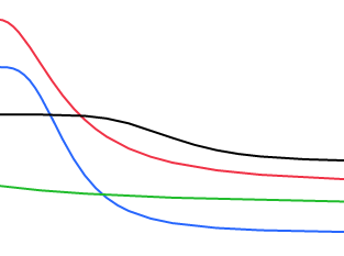

Biexponential 4P
a = Scale 1
b = Decay Rate 1
c = Scale 2
d = Decay Rate 2
Available only when the response values are positive.
Biexponential 5P
a = Asymptote
b = Scale 1
c = Decay Rate 1
d = Scale 2
f = Decay Rate 2
Mechanistic Growth
a = Asymptote
b = Scale
c = Growth Rate

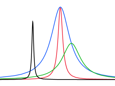

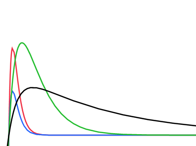

Gaussian Peak
a = Peak Value
b = Critical Point
c = Growth Rate
Lorentzian Peak
a = Peak Value
b = Growth Rate
c = Critical Point
One Compartment Oral Dose
a = Area Under Curve
b = Elimination Rate
c = Absorption Rate
Available only when the response values and the regressor values are all positive.
Two Compartment IV Bolus Dose
α =
β =
a = Initial Concentration
b = Transfer Rate In
c = Transfer Rate Out
d = Elimination Rate
