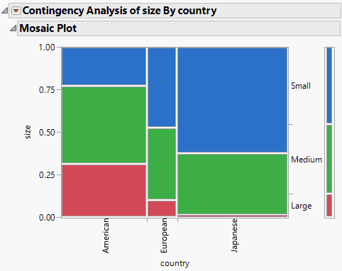

The mosaic plot is a graphical representation of the two-way frequency table or Contingency Table. A mosaic plot is divided into rectangles; the vertical length of each rectangle is proportional to the proportions of the Y variable in each level of the X variable. The mosaic plot was introduced by Hartigan and Kleiner (1981) and refined by Friendly (1994).

Figure 7.5 Example of a Mosaic Plot
Note the following about the mosaic plot:
• The proportions on the horizontal axis represent the number of observations for each level of the X variable, which is country.
• The proportions on the vertical axis at right represent the overall proportions of Small, Medium, and Large cars for the combined levels (American, European, and Japanese).
• The scale of the vertical axis at left shows the response probability. The whole axis is equivalent to a probability of one (representing the total sample).
Clicking on a rectangle in the mosaic plot highlights the selection and highlights the corresponding data in the associated data table.
Replace variables in the mosaic plot by dragging and dropping a variable, in one of two ways: swap existing variables by dragging and dropping a variable from one axis to the other axis; or, click a variable in the Columns panel of the associated data table and drag it onto an axis.
