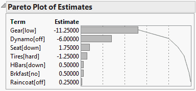

The Pareto Plot report presents a Pareto chart of the absolute values of the estimates. Figure 3.48 shows a Pareto Plot report for the Bicycle.jmp sample data table.

Figure 3.48 Pareto Plot
