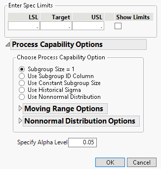

The Process Capability Analysis window appears when you select the Process Capability option from the red triangle next to the name of the analysis variable.
Use the Process Capability Analysis window to specify options for the capability analysis, including specification limits, the underlying distribution for the analysis, and the estimation method for sigma. Process capability requires you to choose how to estimate sigma, the within-group (short-term) variation. Different suboptions appear depending on which process capability option you choose.
Figure 3.12 Process Capability Analysis Window
Enter Spec Limits
Specifies the Lower Spec Limit, the Target, and the Upper Spec Limit for the process capability analysis. At least one of these must be a nonmissing value. If you select the Show Limits option, the specification limits appear on the histogram in the Distribution platform report.
Process Capability Options
Depending on which option you choose, different additional options appear. Choose one of the following options:
Subgroup Size = 1
Sets the subgroup size to 1 and provides additional Moving Range options. See Moving Range Options in Quality and Process Methods.
Use Subgroup ID Column
Enables you to select a subgroup ID column and provides additional Subgrouping and Moving Range options. See Process Subgrouping and Moving Range Options in Quality and Process Methods.
Use Constant Subgroup Size
Enables you to set a constant subgroup size and provides additional Subgrouping and Moving Range options. See Process Subgrouping and Moving Range Options in Quality and Process Methods.
Use Historical Sigma
Assigns a historically accepted value for sigma. See Historical Information in Quality and Process Methods.
Use Nonnormal Distribution
Enables you to select a nonnormal distribution and provides additional Nonnormal Distribution Options. See Distribution Options in Quality and Process Methods.
Specify Alpha Level
Specifies the significance level for confidence limits.
