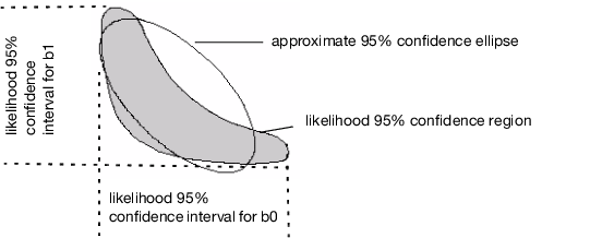

Figure 14.20 shows the contour of the goal SSE or negative likelihood, with the least squares (or least loss) solution inside the shaded region:
• The asymptotic standard errors produce confidence intervals that approximate the region with an ellipsoid and take the parameter values at the extremes (at the horizontal and vertical tangents).
• Profile confidence limits find the parameter values at the extremes of the true region, rather than the approximating ellipsoid.
Figure 14.20 Diagram of Confidence Limits for Parameters
