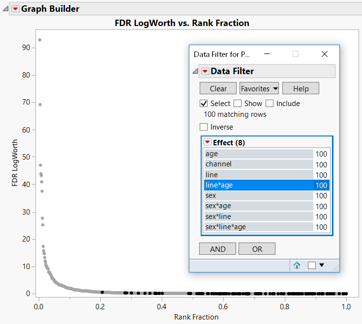

To get a general idea of which effects are important, do the following:
8. Run the FDR LogWorth by Rank Fraction script in the PValues data table.
9. Select Rows > Data Filter.
10. In the Data Filter window, select Effect and click Add.
11. In the Data Filter, click through the list of the model effects while you view the selected points in the FDR LogWorth by Rank Fraction plot.
Keep in mind that values of LogWorth that exceed 2 are significant at the 0.01 level. The Data Filter helps you see that, with the exception of sex and channel, the model effects are rarely significant at the 0.01 level. Figure 21.20 shows a reference line at 2. The points for tests of the line*age interaction effect are selected. None of these are significant at the 0.01 level.
Figure 21.20 FDR LogWorth vs Rank Fraction Plot with line*age Tests Selected
