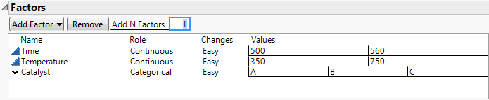

Define the Response and Factors
1. Select DOE > Custom Design.
2. In the Response outline, double-click Y and change it to Yield.
Because your goal is to maximize Yield, leave the Goal set to Maximize.
3. In the Factors outline, type 2 next to Add N Factors.
4. Click Add Factor > Continuous.
5. Click Add Factor > Categorical > 3 Level.
6. Rename the factors Time, Temperature, and Catalyst.
7. Change the Values for Time to 500 and 560.
8. Change the Values for Temperature to 350 and 750.
9. Change the Values for Catalyst to A, B, and C.
Figure 5.46 Factor Settings

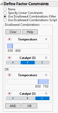

Define the Constraints
1. Select Use Disallowed Combinations Filter in the Define Factor Constraints outline.
2. Select Temperature and Catalyst from the Add Filter Factors list.
3. Click Add.
4. Click 750 in the equation that appears above the Temperature slider and change it to 400. Press Enter (or click elsewhere).
This disallows factor settings with Temperature values below 400.
5. Click the B block under Catalyst.
Together with the constraint on Temperature, this disallows factor settings for which Catalyst is B and Temperature is below 400.
6. Click OR.
This allows you to define your second constraint.
7. Select Temperature and Catalyst from the Add Filter Factors list. (Your earlier selection may have been retained.)
8. Click Add.
9. In the panel that appears beneath the word OR, click 350 in the equation that appears above the Temperature slider and change it to 650. Press Enter (or click elsewhere).
This disallows factor settings with Temperature values above 650.
10. Click the C block under Catalyst.
Together with the constraint on Temperature, this disallows factor settings for which Catalyst is C and Temperature is above 650.
Figure 5.47 Constraints Defined

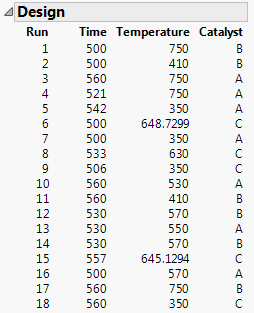

5. Click Make Design.
Figure 5.48 Design Satisfying Constraints
Because you added RSM terms to the Model outline, this is an I-optimal design. It satisfies your constraints:
– When catalyst B is used, the temperature must be above 400.
– When catalyst C is used, the temperature must be below 650.

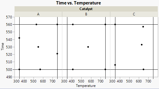

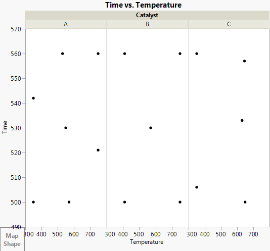

Recall that the design region consists of settings of Time between 500 and 560 and Temperature between 350 and 750. To obtain a geometric view of the design points within the design region, do the following:
1. Click Make Table.
3. Select Time and Temperature and drag them to the center of the template.
4. Deselect the Smoother icon. This is the second icon from the left above the template.
5. Select Catalyst and drag it to the Group X zone at the top of the template.
Figure 5.49 Design Points for Three Levels of Catalyst

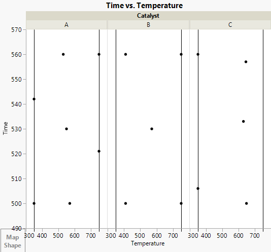

6. Double-click the Temperature axis.
7. Under Reference Lines, do the following:
– Next to Value, enter 350.
– Click Add.
– Next to Value, enter 750.
– Click Add.
8. Click OK.
Figure 5.50 Design Bounds on Temperature for Three Levels of Catalyst
9. Double-click the Time axis.
10. Under Reference Lines, do the following:
– Next to Value, enter 500.
– Click Add.
– Next to Value, enter 560.
– Click Add.
11. Click OK.
12. Click Done.
Note: The plot in Figure 5.51 is vertically resized.
Figure 5.51 Design Regions for Three Levels of Catalyst
Six of the settings for Catalyst A fall on the edges of the design region. All Temperature setting for Catalyst B are above the 400 degree constraint and all Temperature settings for Catalyst C are below the 650 degree constraint.
