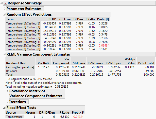

Figure 3.63 shows the report obtained for a fit to the Investment Castings.jmp sample data using the REML method. Run the script Model - REML, and then fit the model. Note that Casting is a random effect and is nested within Temperature.
Figure 3.63 Fit Least Squares Report for REML Method
Random Effect Predictions
For each term in the model, this report gives an empirical estimate of its best linear unbiased predictor (BLUP) and a test for whether the corresponding coefficient is zero.
Note: The Regression Reports > Parameter Estimates option must be selected for the Random Effect Predictions report to appear.
Term
The terms in the model that correspond to random effects.
BLUP
The empirical estimate of the best linear unbiased predictor (BLUP) for each random effect. See Best Linear Unbiased Predictors.
Std Error
The standard error of the BLUP.
DFDen
The denominator degrees of freedom for a test that the effect is zero. In most cases, the degrees of freedom for the t test is fractional.
t Ratio
The t ratio for testing that the effect is zero. The t ratio is obtained by dividing the BLUP by its standard error.
Prob>|t|
The p-value for the test.
Lower 95%
The lower 95% confidence limit for the BLUP. This column appears only if you have the Regression Reports > Show All Confidence Intervals option selected or if you right-click in the report and select Columns > Lower 95%.
Upper 95%
The upper 95% confidence limit for the BLUP. This column appears only if you have the Regression Reports > Show All Confidence Intervals option selected or if you right-click in the report and select Columns > Upper 95%.

REML Variance Component Estimates
When REML is selected as the fitting method in the Fit Model launch window, the REML Variance Component Estimates report is provided. This report contains the following columns:
Random Effect
The random effects in the model.
Var Ratio
The ratio of the variance component for the effect to the variance component for the residual. It compares the effect’s estimated variance to the model’s estimated error variance.
Var Component
The estimated variance component for the effect. Note that the variance component for the Total is the sum of the positive variance components only. The sum of all variance components is given beneath the table.
Std Error
The standard error for the variance component estimate.
95% Lower
The lower 95% confidence limit for the variance component. See Confidence Intervals for Variance Components.
95% Upper
The upper 95% confidence limit for the variance component. See Confidence Intervals for Variance Components.
Wald p-Value
The p-value for the test that the covariance parameter is equal to zero. This column appears only when you have selected Unbounded Variance Components in the Fit Model launch window.
Pct of Total
The ratio of the variance component for the effect to the variance component for the total as a percentage.
Sqrt Variance Component
The square root of the corresponding variance component. It is an estimate of the standard deviation for the effect. This column appears only if you right-click in the report and select Columns > Sqrt Variance Component.
CV
The coefficient of variation for the variance component. It is 100 times the square root of the variance component, divided by the mean response. This column appears only if you right-click in the report and select Columns > CV.
Norm KHC
The Kackar-Harville correction. See Kackar-Harville Correction. This column appears only if you right-click in the report and select Columns > Norm KHC.
