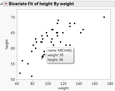

To select a point in a graph, click the point with the arrow pointer. This selects the point as well as the corresponding row in the current data table. To select multiple points, hold down the Shift key while you select points. A point’s label appears when you place the pointer over the point with or without clicking.
Figure 9.18 Label for a Data Point
