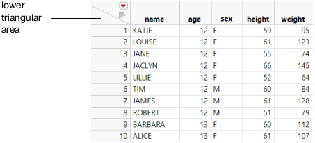

To select or deselect all rows
• To select all rows, select Rows > Row Selection > Select All Rows.
or
• Hold down the Shift key and click the lower triangular area in the upper left corner of the data grid to select. Click again in the same area to deselect all rows (Figure 4.7).
• To clear all highlighted areas in the data table, press the Esc key.
Figure 4.7 Lower Triangular Area
