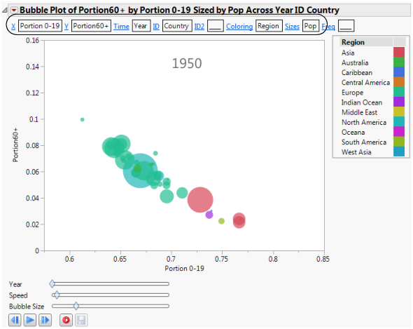

Using the Show Roles option in the red triangle menu, you can make changes to your existing variables without having to relaunch the platform and start your analysis over.
Follow the instructions in Example of a Dynamic Bubble Plot to produce the report window shown in Figure 5.6. (The colors are the JMP default colors.)
Figure 5.6 Example of Bubble Plot with Show Roles Selected
Change the Variable Assigned to a Role
To change the variable assigned to a role, click a blue underlined role name. For example, in Figure 5.6, to change the Coloring variable from Region to Country, proceed as follows:
1. Click the Coloring link.
The Select column for Coloring window appears.
2. Click Country.
3. Click OK.
Country now replaces Region as the Coloring variable in the bubble plot.
