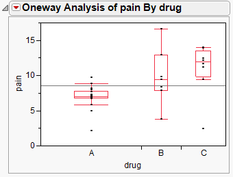

Figure 4.18 Example of Side-by-Side Box Plots

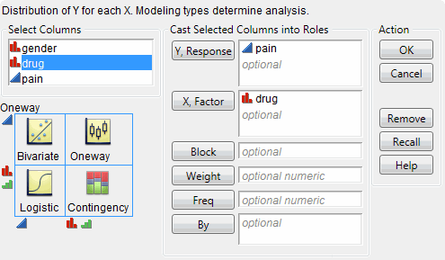

1. Select Help > Sample Data Library and open Analgesics.jmp.
3. Select pain and click Y, Response.
4. Select drug and click X, Factor.
Figure 4.19 Fit Y by X Window
5. Click OK.

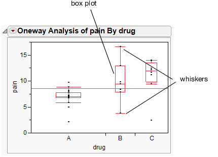

6. Click the red triangle next to Oneway Analysis of pain By drug and select Display Options > Box Plots.
Figure 4.20 Side-by-Side Box Plots
Interpret the Side-by-Side Box Plots
Box plots are designed according to the following principles:
• The line through the box represents the median.
• The middle half of the data is within the box.
• The majority of the data falls between the ends of the whiskers.
• A data point outside the whiskers might be an outlier.
The box plots in Figure 4.20 show these answers:
• There is evidence to believe that patients on drug A feel less pain, since the box plot for drug A is lower on the pain scale than the others.
• Drug B appears to have higher variability than Drugs A and C, since the box plot is taller.
There is one point for drug C that is a lot lower than the other points for drug C. Place your mouse pointer over it with your mouse to see that it is row 26 of the data table. That point looks like it is more similar to the data in drug group A or B. The information in row 26 deserves investigation. There might have been a typographical error when the data was recorded.
