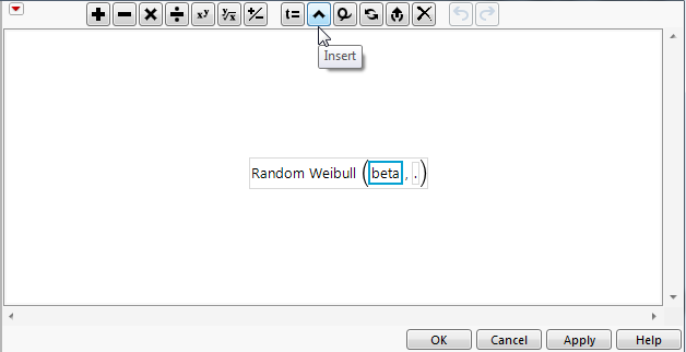

5. In the formula editor, select Random > Random Weibull.
6. The placeholder for beta is selected. Click the insertion element (^).
Figure 7.28 Formula Editor for Simulated Purity Column
This adds a placeholder for the parameter alpha.

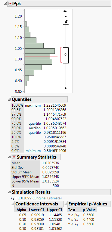

7. In the Overall Sigma Capability report, right-click the Estimate column and select Simulate.
In the Column to Switch Out list, make sure Purity is selected. In the Column to Switch In list, make sure Simulated Purity is selected.
8. Next to Number of Samples, type 500.
Note: The next step is not required. However, it ensures that you obtain exactly the simulated values shown in this example.
9. (Optional) Next to Random Seed, type 12345.
10. Click OK.
The calculation might take several seconds. A data table entitled Process Capability Simulate Results (Estimate) appears. The Ppk and Ppl columns in this table each contain 500 values calculated based on the Simulated Purity formula. The first row, which is excluded, contains the values for Purity obtained in your original analysis. Because Purity has only a lower specification limit, the Ppk values are identical to the Ppl values.
11. In the Process Capability Simulate Results (Estimate) data table, click the green triangle next to the Distribution script.
Figure 7.30 Distribution of Simulated Ppk Values for Purity
Note: Your values may vary slightly from what is shown, depending on the decimal precision of the parameters in the Simulated Purity column formula.
Two Distribution reports are shown, one for Ppk and one for Ppl. But Purity has only a lower specification limit, so that the Ppk and Ppl values are identical. For this reason, the Distribution reports are identical.
The Simulation Results report shows that a 95% confidence interval for Ppk is 0.909 to 1.145. The true Ppk value could be above 1.0, which would place Purity above the Ppk = 1 line in the Capability Index Plot you constructed in Nonnormal Capability Analysis.

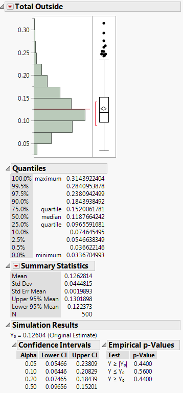

12. In the Process Capability report, right-click the Expected Overall % column in the Nonconformance report and select Simulate.
13. Next to Number of Samples, enter 500.
14. (Optional) Next to Random Seed, enter 12345.
15. Click OK.
The calculation might take several seconds. A data table entitled Process Capability Simulate Results (Expected Overall %) appears. Because Purity has only a lower specification limit, the Below LSL values are identical to the Total Outside values.
16. In the Process Capability Simulate Results (Expected Overall %) data table, click the green triangle next to the Distribution script.
Figure 7.31 Distribution of Simulated Total Outside Values for Purity
Again, two identical Distribution reports appear. The Simulation Results report shows that a 95% confidence interval for the Expected Overall % nonconforming is 0.055 to 0.238.
