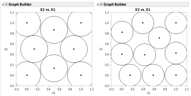

• maximize the distance between any two design points
• space the points uniformly
Figure 21.1 Space-Filling Design
