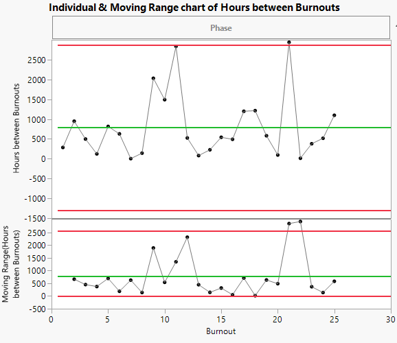

3. Drag Hours between Burnouts to the Y role.
4. Drag Burnout to the Subgroup role.
Figure 3.24 Individual and Moving Range Chart of Hours Between Burnouts
5. In the drop-down list, select Rare Event instead of Shewhart Variables.
A G chart of Hours between Burnouts appears.

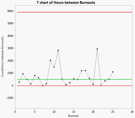

6. Under Limits, change the Sigma from Negative Binomial to Weibull.
Figure 3.25 T chart of Hours Between Burnouts
In the T chart, all points appear to be within the control limits. It’s clear that the Individual & Moving Range chart was inappropriate for the analysis, as the limits were too narrow.
