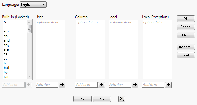

The Term Options management windows are four similar windows that enable you to manage the collections of stop words, recodes, phrases, and stem exceptions. Figure 12.9 shows the Manage Stop Words window. The Manage Phrases and Manage Stem Exceptions are identical to the Manage Stop Words window. The Manage Recodes window differs slightly. See Manage Recodes.
Figure 12.9 Manage Stop Words Window
Manage Stop Words
The Manage Stop Words window contains multiple lists of stop words that represent the different scopes (or locations) of specified stop words. Below each list is a text edit box and an add button. These controls enable you to add custom stop words to each scope. You can move stop words from one scope to another by dragging them. You can copy and paste items from one list to another list. Two buttons at the bottom of the window move the selected items from one scope to the next, either left or right. The X button removes the selected items from their current scope. You can edit existing items in the lists by double-clicking on an item and changing the text.
Language
Specifies the list of Built-in stop words and to which language the user library selections are saved. If you select Apply Items for Language, the changes are saved to the master user library. The Language setting applies only to the Built-in, User, and Project scopes.
Built-in (Locked)
Lists the built-in list of stop words for the specified language. You can exclude a built-in stop word by placing it in the Local Exceptions list.
User
Lists the stop words in the user library for the specified language.
Project
(Available only when Text Explorer is launched within a project that contains a folder named “TextExplorer”.) Lists the stop words in the current project for the specified language.
Column
Lists the stop words in the “Stop Words” column property for the text column.
Local
Lists the stop words in the local scope. They can be specified when Text Explorer is launched via JSL. These stop words are used only in the current Text Explorer platform report.
Local Exceptions
Lists words that are not treated as stop words in the current Text Explorer platform. They can be specified when Text Explorer is launched via JSL. The words listed in Local Exceptions override words listed in all of the other scopes.
Import
Enables you to import stop words from a text file. The stop words are copied to the clipboard. You can paste them into any of the lists other than Built-in.
Export
Enables you to export stop words to the clipboard or to a text file. An Export window appears that enables you to select the scopes for which you would like to export stop words and the location of the export.
