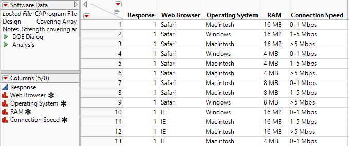

The Covering Array data table contains a first column where you can enter the response. The remaining columns give the factor settings.
The Table panel in the upper left contains a Design note indicating that the design is a Covering Array and giving the Strength of the design. The Table panel also contains the following scripts.
DOE Dialog
Re-creates the Covering Array window that you used to generate the design table.
Disallowed Combinations
Shows factor level restrictions that you entered in the Restrict Factor Level Combinations outline.
Analysis
Provides an analysis of your experimental data. For more information about the script, see Analysis Script. For background, see Zhang and Zhang (2011).
Tip: To run a script, click the green triangle next to the script name.
Figure 20.22 Partial View of Covering Array Table for Software Data.jmp Showing Scripts
