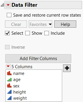

Figure 9.7 Initial Data Filter Window
2. Select the columns that you want to use as filters, and then click Add .
Notes:
• To restore your current row states when the Data Filter window is closed, select the Save and restore current row states option.
• If you have a long list of columns, you can sort, show, hide, or search for columns in the list. Use the options in the Add Filter Columns red triangle menu. See Search Filter Options for more information about refining your search.
