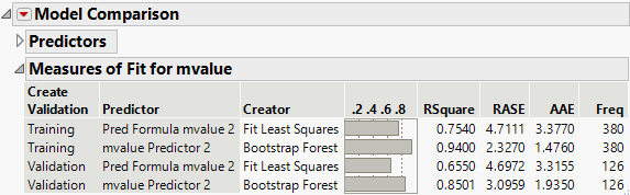

Figure 10.7 shows an example of the initial Model Comparison report for a continuous response.
Figure 10.7 Initial Model Comparison Report
The Predictors report shows all responses and all models being compared for each response. The fitting platform that created the predictor column is also listed.
The Measures of Fit report shows measures of fit for each model. The columns are different for continuous and categorical responses.
Measures of Fit for Continuous Responses
RSquare
The r-squared statistic. In data tables that contain no missing values, the r-squared statistics in the Model Comparison report and original models match. However, if there are any missing values, the r-squared statistics differ.
RASE
The square root of the mean squared prediction error. This is computed as follows:
– Square and sum the prediction errors (differences between the actual responses and the predicted responses) to obtain the SSE.
– Denote the number of observations by n.
– RASE is:
RASE =
AAE
The average absolute error.
Freq
The column that contains frequency counts for each row.
