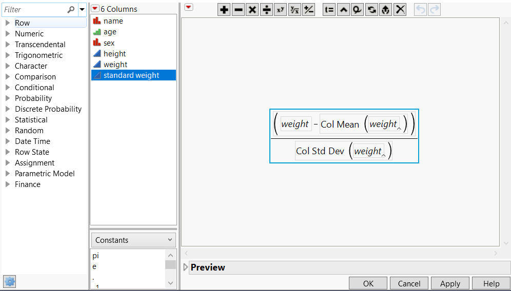

Next, enter the formula that standardizes the weight values.
1. While the initial missing term is selected, click weight in the Columns list.
2. Click the minus button in the Formula Editor keypad.
A new missing term appears after the minus sign as shown in Figure 7.20.
3. Click weight again.
4. Click the Functions list, and select Statistical.
5. Select Col Mean from the Statistical list.
6. Select the entire expression.
The blue box should now enclose the whole formula.
7. Click the division button in the keypad.
The result gives a selected missing denominator for the whole expression.
8. Click weight again from the column selector list.
It becomes selected in the denominator.
9. Select Col Std Dev from the Statistical list.
Figure 7.20 Building a Formula
10. Close the Formula Editor by clicking OK.
11. Close the Column Info window by clicking OK.
In the data table, the new Standard Weight column fills with values. When a weight value changes, the calculated Standard Weight value automatically recalculates.
