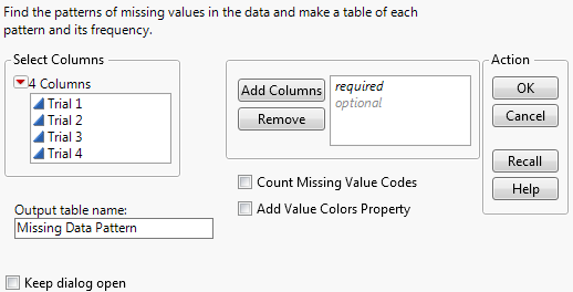

Figure 4.18 The Missing Data Pattern Window
3. Highlight all of the columns.
Note: For more information about the options in the red triangle menu, see Column Filter Menu in the Get Started section.
4. Click Add Columns.
5. Click OK.

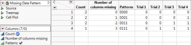

Figure 4.19 A Missing Data Pattern Table
Tip: To quickly create a Treemap or Cell Plot of the data, click the green triangle next to the Treemap or Cell Plot script in the table panel.
Figure 4.19 shows the following patterns:
• Row 1 shows that there are two instances where all rows in Trial 1, Trial 2, Trial 3, and Trial 4 have no missing values.
• Row 2 shows that there are two rows in the source table whose one missing value is in the Trial 4 column.
• Row 3 shows that there are two rows in the source table whose missing values are in the Trial 3 and Trial 4 columns.
• Row 4 shows that there is one row in the source table whose three missing values are in the Trial 2, Trial 3, and Trial 4 columns.
The Count column is assigned the frequency role. If you now use the Missing Data Pattern data table to run an analysis, JMP automatically uses Count as a frequency. See Assign a Preselected Analysis Role in the The Column Info Window section.
