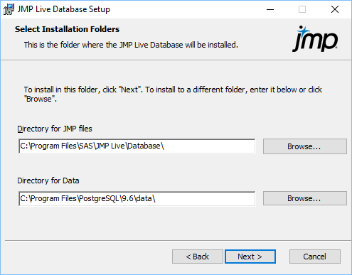

Figure 1.2 Specify Installation Folders
Specify where to install the JMP Live database and the PostgreSQL database:
Click Next to accept the default location.
Click Browse to change the default installation folder.
Note: Make sure you have adequate space in the directory where you install the PostgreSQL database.

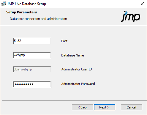

Figure 1.3 Specify Database Parameters
5.
Enter these parameters:
Port: The TCP port that PostgreSQL uses to communicate with other databases. This is usually 5432.
Database Name: The name of the default database that JMP Live uses. It is recommended to keep this set to webjmp. The administrator user ID cannot be changed from dba_webjmp.
Administrator Password: The administrator password, which is Password1 by default. It is strongly recommended that you change this password.

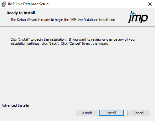

Figure 1.4 Start JMP Live Database Installation
6.
Click Install to proceed, and Finish once this installer is done.

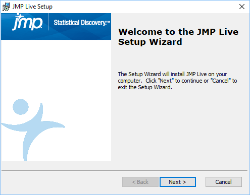

Navigate to the location where you downloaded the JMP Live installer, JMPLive.msi. Double-click the file to run it.
Figure 1.5 JMP Live Setup Wizard
Click Next.

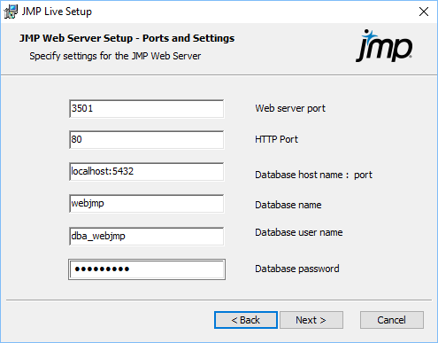

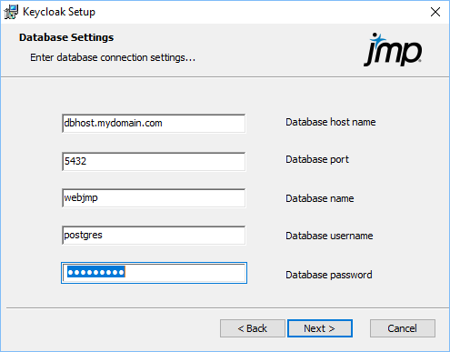

Figure 1.8 Specify Ports and Database Details
6.
Specify the following JMP web server settings:
Web server port: Enter the HTTPS port that will take requests from a browser. By default, this port is set to 3501. You can specify port 443 (the default HTTPS port), but it is recommended to use a dedicated port for easier monitoring and access control. If you install an application load balancer in front of the web server component, specify this port.
HTTP Port: Enter the HTTP port. The default setting of 80 should be adequate for most purposes. Some organizations use 8080, so you can specify that port if required.
Database host name : port:
Enter the DNS name of the machine that is running the PostgreSQL database for JMP Live. The default is localhost (the install machine), but typically this would specify a dedicated server running PostgreSQL. This machine could be within a corporate firewall, outside, or in a cloud service.
Enter the port that was specified during the installation of PostgreSQL for communication from the outside. The default PostgreSQL port is 5432.
Database name: Enter the name assigned to the JMP Live database within PostgreSQL. It is possible to change this name, but not recommended, as the database installer defaults to webjmp.
Database user name and Database password: Enter the administrator user ID and password that you specified while installing the JMP Live Database. The Database user name should be dba_webjmp, but you likely changed the password from the default (which is Password1). Enter that password here.

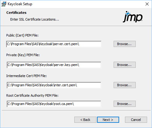

Figure 1.10 Specify SSL Certificates
8.
Navigate to or enter the SSL certificates for your organization.
SSL certificates are text files containing cryptographic keys that enable a browser and the web server to have secure communication. These keys are specific to an organization and are provided by third-party vendors like DigiCert, Symantec, and Network Solutions. JMP Live cannot run without these certificates.
The primary certificate and key are configured for the purchaser. The Root (CA) certificate comes from the third-party vendor.
The JMP Live installer provides a certificate set that allows for minimal testing on a localhost setup. However, it generates warnings when the site is viewed in the local browser, and the site is inaccessible from browsers outside the install machine.

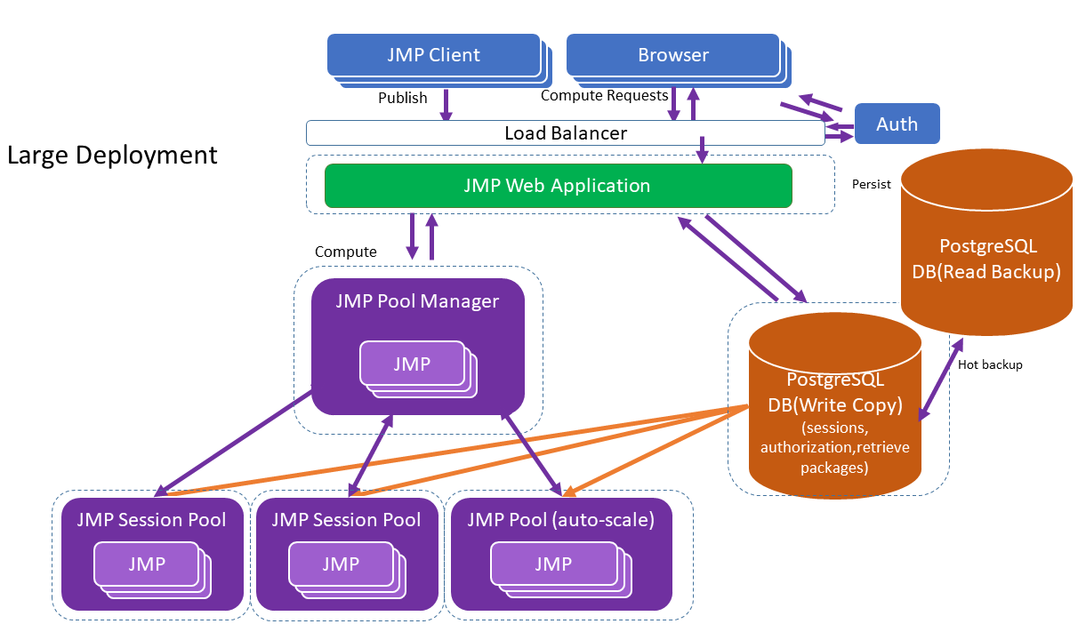

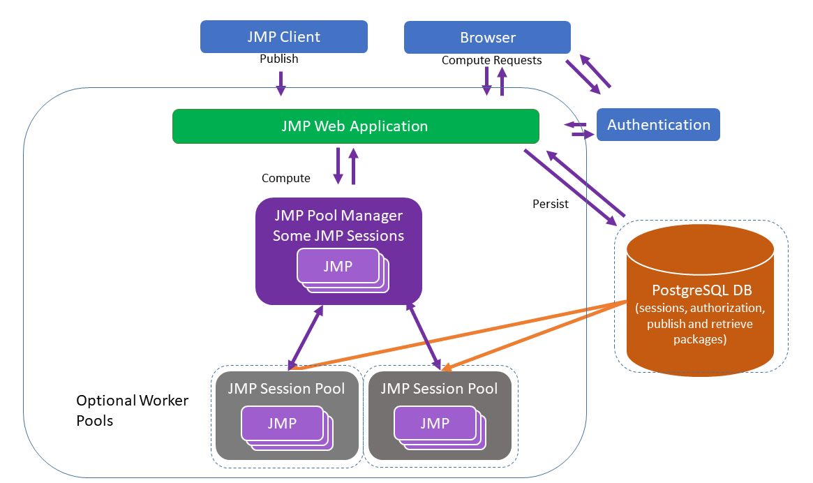

Figure 1.11 Configure the Pool Manager
10.
If you want to run the Pool Manager on this machine, select the Configure as Pool Manager box:
If you are using one machine for all components, or one machine for the Pool Manager and JMP sessions, select this option.
If you are using this machine for a worker pool only, do not select this option.
11.
Specify the Pool Manager options:
Web host name: Enter the DNS name, which typically looks like this: machine name.domain name.com/org. Note the following:
Unless you are installing all components using the localhost option, you need to specify the web host name.
Even if you have all components on one machine, you will likely want to use your organization's SSL certificates for a secure connection. In that case, specify the machine name as the web host name, since the certificates are usually tied to the machine.
Pool Manager host name: (Disabled if you are selected Configure as Pool Manager.) If you are setting up a worker pool on a separate machine, enter the DNS name of the machine that is handling the Pool Manager duties.
Web server port: (Disabled if you are installing all components on the same machine, as the port number is already specified in the JMP web component.) If you are installing only the JMP Pool component, enter the port that you used when installing the JMP web component on another machine.
Pool listening port: Enter the port that this pool is listening on for communication from the JMP Pool Manager and JMP web components.
Pool Manager listening port: (Enabled only if you are configuring a worker pool.) Enter the port that was specified as the Pool listening port for the JMP Pool Manager setup. The worker pool needs to know this port in order to tell the JMP Pool Manager that it is available.

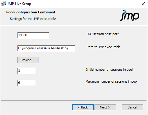

Specify these JMP details:
JMP session base port: Enter the base port used by the JMP sessions to talk with the JMP Pool Manager. Each instance of JMP has a unique number starting with this base number.
Path to JMP executable: Enter the path to the JMP Pro location. The default installation path appears, so you need to change this only if JMP Pro is located elsewhere.
Initial number of sessions in pool: Enter the number of JMP sessions that will be started when the pool is first run.
Maximum number of sessions in pool: Enter the upper limit for the number of JMP sessions that are allowed to run on this machine as part of this pool. These sessions are added if the number specified in the initial number of sessions are all in use.

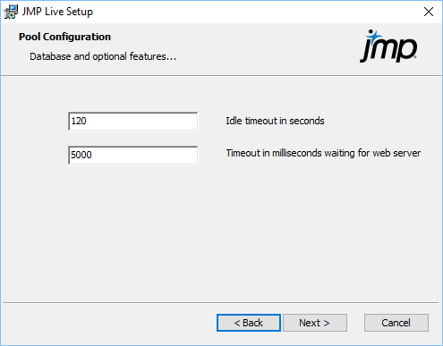

Figure 1.13 Configure JMP Settings
13.
Idle timeout in seconds: Enter the length of time that a JMP instance waits for additional work before dropping the connection with the JMP web component and waiting for a new request.
Timeout in milliseconds waiting for web server: Enter how long an instance waits for further communication during an existing transaction before it gives up and discards the existing work request.

JMP_BASE_PORT
(Required) Start of a range of ports that JMP sessions listen on.

INITIAL_JMP_PROCESSES
(Optional) Number of JMP sessions that will be started to help recalculate reports when they are explored on the website. The default is 4 sessions.
MAX_JMP_PROCESSES
(Optional) Maximum number of JMP processes that will be launched based on demand (an elastic JMPPool). The default is INITIAL_JMP_PROCESSES.
JMP_SERVER_IDLE_TIMEOUT
(Optional) Amount of time (in seconds) a committed JMP server can remain idle before being recycled. The default is 120 seconds.

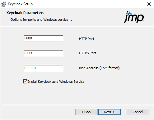

Figure 1.19 Configure Ports and Services
6.
Specify these Keycloak details:
HTTP port: Enter the HTTP network port. The default is 8888. This port needs to be open to the Keycloak server.
HTTPS Port: Enter the HTTPS network port. The default is 8443. This port needs to be open to the Keycloak server.
Bind Address (IPv4 format): Enter the IP address that the Keycloak instance listens on (using the specified port numbers) for requests. The default is 0.0.0.0, which means that Keycloak accepts connections on all IP addresses assigned to the machine where Keycloak is installed.
Install Keycloak as a Windows Service: Select this option to install Keycloak as a Windows service. This means that Keycloak will automatically be started, and if the machine reboots it will automatically restart, so that it is always running. If you do not select this option, you will need to start Keycloak manually the first time and anytime the machine is rebooted. This option is selected by default, and it is recommended to keep it selected.
7.
Click Next.
Figure 1.20 Specify Keycloak Certificates
Keycloak requires SSL certificates to guarantee your organization's authenticity and to allow secure connections between Keycloak and identity providers.
8.
Specify the locations of your organization’s SSL certificates. These must be obtained from an authorized provider.
9.
Click Next.
Figure 1.21 Configure Database Parameters
Keycloak stores information about users and clients in a database.
10.
Specify the database information:
Note: The following information should match what you entered when you installed the JMP Live database. See Install the JMP Live Database.
Database host name: Specify the alias or DNS name of the machine with the JMP Live database.
Database port: Specify the port that the database listens on.
Database name: Specify the name of the JMP Live database.
Database username: Specify the username of the database administrator.
Database password: Specify the password of the database administrator.
11.
Click Next.

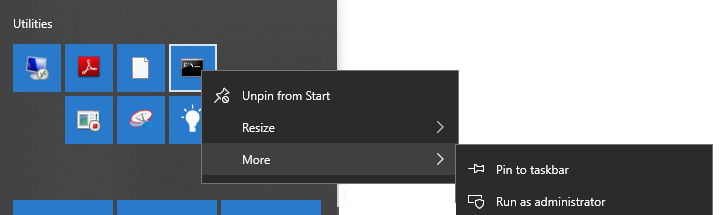

Open a Windows command prompt. If you are using Windows 10, type Command Prompt in the search bar. Run the command prompt as an administrator (right-click Command Prompt and choose Run as administrator).

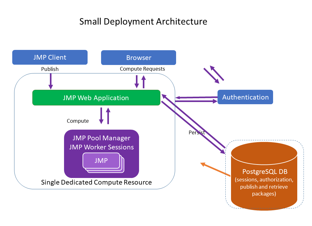

In a small deployment (100 users), it is possible to install everything except the database on a single dedicated machine.
Figure 1.27 Recommended Configuration for a Small Deployment
In this scenario, the JMP web and the JMP Pool components are installed on the same machine. During the installation, you should select the option to Configure as Pool Manager. The number of JMP instances associated with this JMP Pool Manager are the total number of JMP instances that are run for the site.
For the capabilities of this computing resource, more is always better, and much depends on the processor type, network speeds, and so on. An absolute minimum to consider is a 4-core machine with at least 16 GB of dedicated RAM. The amount of storage is most important for the database and depends on the number of reports stored. A one-terabyte storage is a minimum.
Medium Deployment

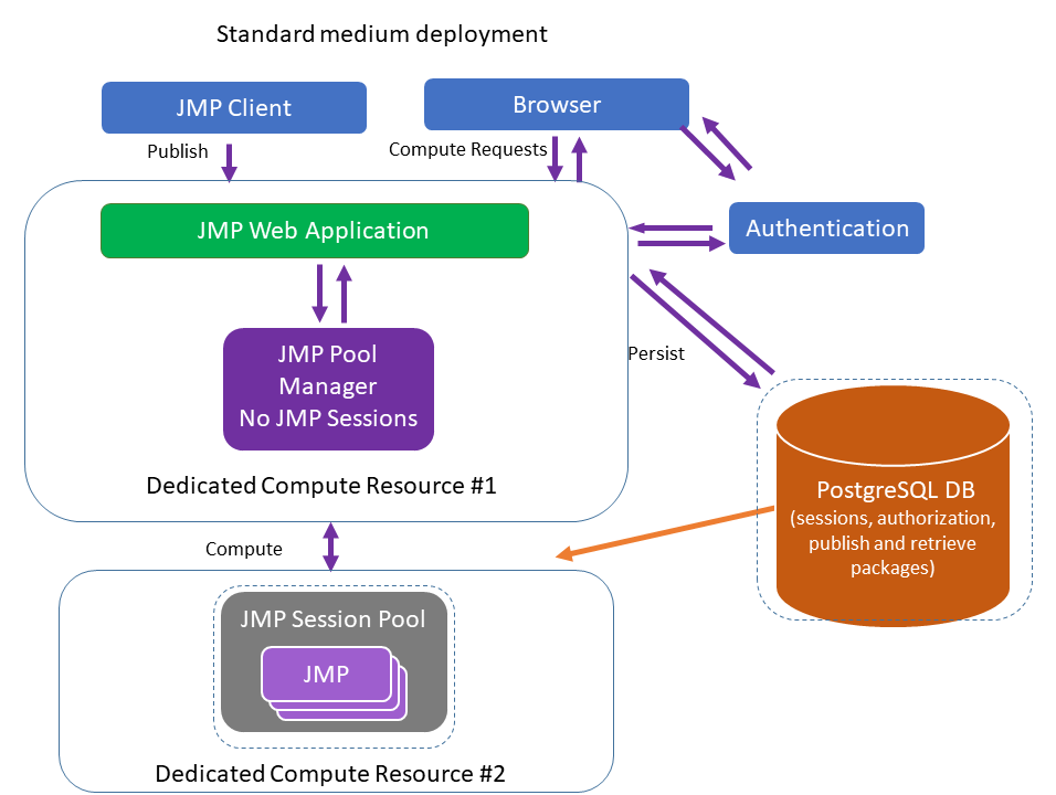

In a medium deployment (500 users), there are two configurations that you can consider, based on the type of reports that are being retrieved:
If you have a high number of report retrievals, but the reports themselves do not contain data filters or the need to recompute the statistics, then the primary area of concern is the JMP web component.
If there are a lot of report computations required, then the primary area of concern is the JMP Pool Manager.
In cases where the JMP web component is of primary importance, or if you do not know whether you will have a compute-intensive environment, the recommended configuration is below.
Figure 1.28 Recommended Configuration for a Medium Deployment
In a standard configuration where the JMP web component needs optimum performance, the JMP Pool Manager does not have JMP sessions of its own. You set the number of JMP sessions in the JMP Pool Manager to zero. All JMP sessions reside on the second computing resource, the JMP Session Pool.
If you need a more compute-intensive environment, then assign sessions to the JMP Pool Manager (perhaps five). This might reduce the performance of the JMP web component, but provides additional computing capacity for reports.
Large Deployment
In a large deployment (2,000 users), you might need multiple JMP Session Pools and a separate dedicated computing resource for the JMP Pool Manager.
Figure 1.29 Recommended Configuration for a Large Deployment
The JMP web component, JMP Pool Manager component, JMP Session Pools, and PostgreSQL databases are all dedicated instances. The number of JMP sessions that you can have depends on the computing power and memory capacity of each instance.
Here are some suggestions for each instance:
JMP web component and JMP Session Pool instances: A suggested minimum of 4-core machines, but preferably 8-core machines with 32 GB of RAM.
JMP Pool Manager: A suggested minimum of a 4-core machine with 16 GB of RAM.
PostgreSQL databases: The machines should anticipate the storage requirements based on the volume of publishing for your organization. A scalable instance would be best, otherwise 5 TB of storage is a suggested minimum.
The following elements are also suggested:
A load balancer to provide a single entry point to handle the security of HTTP and HTTPS requests.
A read backup of the PostgreSQL database to provide a quick switchover in the event of a failure or connectivity issue with the primary database. The backup should be updated frequently.

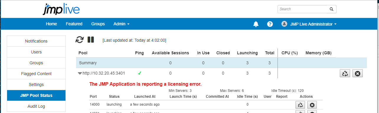

How to Tell if Your JMP License Has Expired
If you are signed in as an administrator to JMP Live, at the top of the JMP Pool Status page, you will see this message: “The JMP Application is reporting a licensing error.” Also, you might notice that reports are not recalculating results.
Figure 1.31 JMP Live Licensing Error Message
