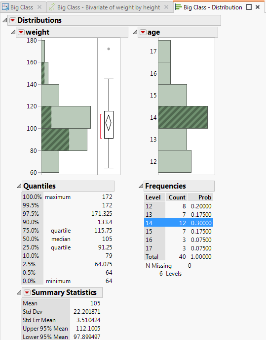

A JMP project provides a way to organize files that you use in an analysis and display the output. A simple project might display the data table, graphs, and reports on separate tabs in the project window.

Figure 15.1 shows the project with selected bars, showing that the graph is still linked to the data table.
Figure 15.1 Example of a Simple Project
