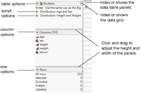

Data tables contain three panels:
• Table panel
• Columns panel
• Rows panel
These panels are located on the left of the data grid. They contain information about the table and its contents. Each panel has interactive areas.
Figure 2.4 Interacting with the Data Table Panels
Table Panel
The Table panel contains the following elements:
• Name of the data table
• Icons indicating the table state
• Red triangle menus containing table and script options
• (Optional) Table variables
• (Optional) Table scripts
Figure 2.5 Example of a Table Panel

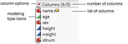

Columns Panel
The Columns panel provides a way to view and move columns. The panel contains the following information:
• Column options (contains some of the same options as the Cols menu)
• Total number of columns and number of columns selected in the data table
• A list of columns found in the data table
• Icons indicating each column’s modeling type (see About Modeling Types in the The Column Info Window section)
• Icons representing characteristics and properties assigned to the columns (not shown, see Figure 2.7)
Figure 2.6 Example of a Columns Panel

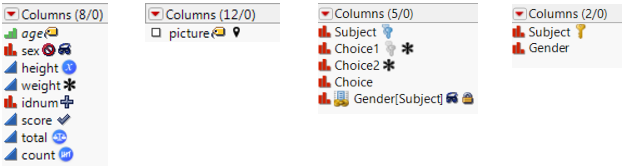

Icons Representing Column Characteristics and Properties
Icons to the right of each column name indicate characteristics and properties the columns contain.
Figure 2.7 Icons Indicating Column Characteristics and Properties
Note: Italics indicate that the column is locked into place. When you scroll horizontally, the column remains visible.
Icons that can appear in the Columns panel are described as follows:
Image shown here Indicates that points on plots corresponding to the column are labeled by the value instead of the row number. See Label Rows and Columns in the Enter and Edit Data section.
Image shown here Indicates that the column is excluded from the calculations. See Exclude Rows in the Enter and Edit Data section.
Image shown here Indicates that the column is not included in graphs. See Hide Rows in the Enter and Edit Data section.
Image shown here Can be X or Y. Indicates that the column has been assigned the preselected role of x or y. See Assign a Preselected Analysis Role in the The Column Info Window section.
Image shown here Indicates that the column contains one or more properties. Click to reveal a list of properties the column contains.
Image shown here Indicates that the values in the column result from a formula. When formula evaluation is suppressed, the icon appears gray. Double-click to view and edit the formula. See Use Formula Editor Options in the Formula Editor section.
Image shown here Indicates that the range check or the list check option is turned on. Click to view and edit the range or list. See Range Check in the The Column Info Window section and List Check in the The Column Info Window section.
Image shown here Indicates that the column has been assigned the preselected role of weight. See Assign a Preselected Analysis Role in the The Column Info Window section.
Image shown here Indicates that the column has been assigned the preselected role of frequency. See Assign a Preselected Analysis Role in the The Column Info Window section.
Indicates that the column values cannot be edited. See About the Column Info Window in the The Column Info Window section.
Indicates that the expression column contains images that can be used as markers. See Use Images as Markers in the JMP Reports section.
Virtual Join Icons
Indicates that the column has a Link Reference column property. This property links a column in the current data table to the ID column in the referenced data table. Blue indicates that the referenced data table is linked.
Indicates that the column has a Link Reference column property. Gray indicates that the referenced data table is not open or not linked properly.
Indicates that the column has a Link ID column property, which marks a column in the data table as the ID column. That is, the rows of the data table are uniquely identified by the values of the ID column.
Indicates that the column is linked from the referenced data table.
For more information about virtual join, see Virtually Join Data Tables in the Reshape Data section.

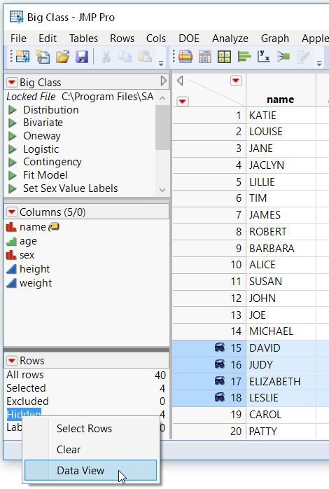

Rows Panel
The Rows panel contains the following information:
• Row options (same options as the Rows menu)
• Total number of rows
• Number of selected (highlighted), excluded, hidden, and labeled rows
Figure 2.8 Example of a Rows Panel
Right-click the categories in the Rows panel to select rows, clear the selection, or to create a data view.
A data view creates a linked subset of the main data table. For example, if several rows are marked hidden, you might want to open a window that shows you only the hidden rows. Right-click Hidden in the Rows panel and select Data View.
Figure 2.9 Creating a Data View from the Rows Panel
When using a data view, continue to do most of your editing in the main data table. When you make changes in either the main data table or in the data view, the changes are reflected in both. You can make minor changes (such as changing some data or adding a column) in the data view. However, if you want to make major changes (like adding a formula) you must make those changes in the main data table.
