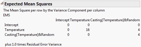

Figure 3.64 shows the Expected Mean Squares report for the Investment Castings.jmp sample data table. Run the Model - EMS script and then run the model.
Figure 3.64 Expected Mean Squares Report
As indicated by the table, the expected mean square for Casting[Temperature] is
