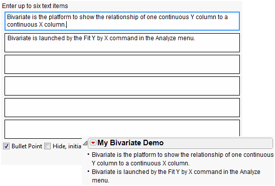

4. To add bullet points into the outline, click the red triangle in the My Bivariate Demo title bar and select Add Text Item.
5. Enter the text shown in the following figure.
6. Select the Bullet Point check box and click OK.
Figure 10.11 Add Text Item

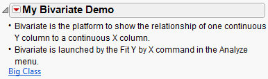

Now add a window reference as a link. These links lets you open a file with one click during the presentation.
7. Select Help > Sample Data Library and open Big Class.jmp.
8. Click the red triangle in the My Bivariate Demo title bar and select Add Window Reference.
9. Select Big Class and click OK.
Figure 10.12 Add a Window Reference
10. Click the window reference to verify the link.

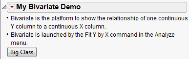

11. Display the window reference as a button by right-clicking the link and deselecting Underline Style.
Figure 10.13 Change the Link to a Button
